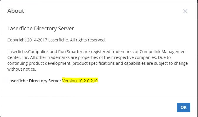

Hi everyone, i need to upgrade from 10.2 to 10.4. I have LDFS and two environments prod and test. Could you please help me to take the best path to do it knowing that I have to upgrade first our test environment to check all the forms, wf, etc. that are working on production before the prod upgrade. I dont know if LFDS 10.2 can give the approprote version licensing for 10.4 (server, webclient, forms and mobile app).

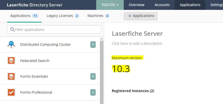

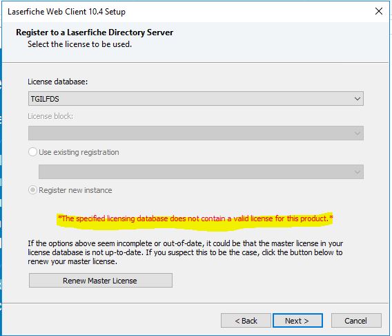

LFDS shows maximum version 10.3 and when i try to install a 10.4 module like webclient it shows that the server does not contain a valid license. I must renew the license without affecting the actual servers registrations berfore start the upgrade of test environment¿?
replied on February 8, 2021
Did you renew your master license to get the latest version? Renewing the master license does not affect existing products.
Is your LSAP current?
Ok, thanks for your indications. I will renew the license in LFDS. You confirm me there will be no problem with the current registrations I was worry about that. LSAP up to date no problem there.
