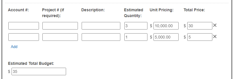

I ran into an issue with the output of calculated sub-total and total fields. I need to calculate the amount based on unit quantity and price per unit in a table and after that I need a total for all the units together. I have that working fine. My issue is that when I put in the price in thousands per unit the subtotal and total fields gives an output in only 2 or 3 digits without showing the zeros. As you can see in the example below it shows the total to be 30 instead of 30,000 and 5 instead of 5,000 and 35 instead of 35,000. How can I format that?

replied on February 1, 2021
I think it is because you have the option to show commas, which converts the number fields to a text fields and the comma comes over with the value.
So you are trying to parseNumber("5,000") instead of parseNumber(5000)
You can either turn off the commas or use a function to convert the strings back to numbers.
Turning off the commas fixed the problem. The function did not seem to work. If I use the function would I get the commas in the output? Is there a way to have commas in all the currency fields?

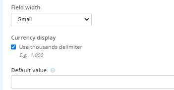

In the currency field, check the box for Delimiters
I do have that box checked but it does not make a difference.
