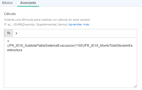

Hi,
How can I disable or modify the formula of a field using javascript?
Thanks,

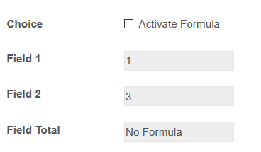

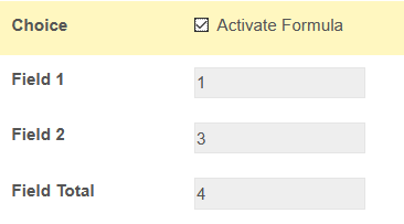

Hi Luis
This is my method to sum 2 fields when checkbox is checked (formula) or to write something when is not checked (not formula) using Javascript (and only javascript, no formula !)
//When document is ready
  //DO check_formula when the document is ready
  check_formula();
  //DO check_formula when the checkbox change
  $('#Field4-0').change(function()
    	check_formula();
//Check_formula
function check_formula(){
  	//Get Checkbox
  	var checkBox = document.getElementById("Field4-0");
    // If the checkbox is checked, execute the formula
  	if (checkBox.checked == true){
      	//GET Field 1 and Field 2
      	var field1 = $('#q1 input').val();
      	var field2 = $('#q2 input').val();
      	//Change STRING to INT
      	field1 = parseInt(field1);
        field2 = parseInt(field2);
        //SUM Field1 and Field2
      	var total  = field1 + field2;
      	//SET Field Total
      	$('#q3 input').val(total);
  	} else {
      	//SET Field Total = "No formula"
      	$('#q3 input').val("No Formula");
You need to know how to get ID or Class Name for each element.

replied on January 27, 2021
What is the reason for changing  or disabling the formula?
replied on January 28, 2021
Hi Steve,
Because Forms shows an error when submitting the form and the formula has no result.
replied on January 28, 2021 Show version history
You are fast Steve XD
This is mine (still using my Print Screen)
=IF(Choice.Activate_Formula,SUM(Field_1,Field_2),"Return String")
(Put this formula inside the Field Total)
