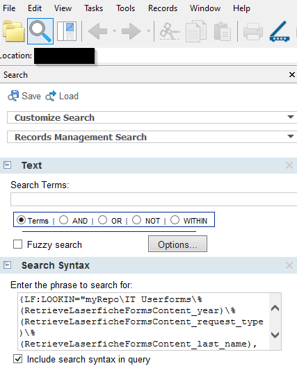

I meant just run your search query directly from the client to make sure it finds a document.  Belt and suspenders.
replied on January 25, 2021 Show version history
I didn't know I could do that.
When I entered my search info there, it built a Search Query with a different syntax:
({LF:Basic~="%(BP Instance ID)", option="LTF"}) &  {LF:LOOKIN="myRepo\IT Userforms\%(RetrieveLaserficheFormsContent_year)\%(RetrieveLaserficheFormsContent_request_type)\%(RetrieveLaserficheFormsContent_last_name), %(RetrieveLaserficheFormsContent_first_name)"}
I'm testing this now.
Edit: and yes, this did return the document in the repository

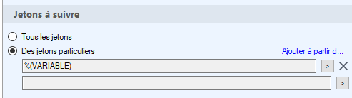

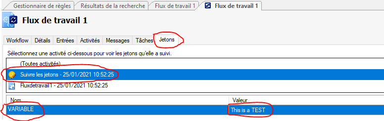

Hi Jennifer,
If when you find 1 entry manually, and 0 entry when your workflow running, in my mind is because you are using a variable in your search query and then this variable is not correct.
In your Workflow, try to check your variable using "Follow the tokens" .
On the right side, under the properties, check "particular tokens" and select the variable you are using for your search query.
Then execute your workflow and check your variable.
