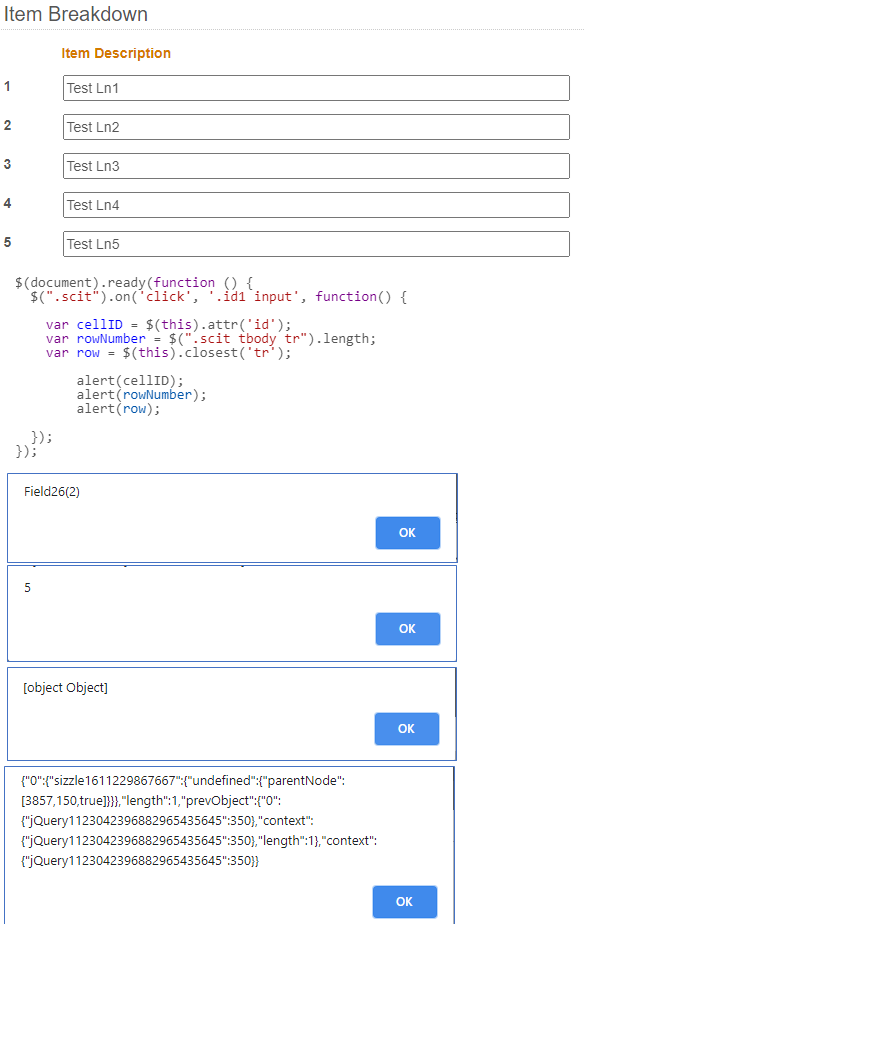

I thought that this will be a simple step but cannot seem to get a result. I’m simply trying to get the row number of in a table. The table data populate from a lookup statement. The row number was going to be used for comparing text (at a later stage).
I have tried so many variation of jquery code but cannot seem to get the row number.
The table (class name “scit”) has one column consisting of text (class name “id1”). At this stage the click is only set on the text field for testing but will move it later.
As per the attached alerts, the td id and row count do return correct values but not the actual row no.
Thank you for the assistance,
John

Thank you. That helps, that is an easier way to add row numbers in future. Can I ask you another question.
How do I call the row number value and use it as a variable. I'm not sure what am I doing wrong here. When I click on row two, I expect a variable of 2 but get 1. It would seem it take the value from the first row. The ROWID column class is "rowid".

Hi John, so what are you trying to get to as the end state? I always look to see if I can do this with formulas before resorting to JS.
replied on January 21, 2021
Hi Steve
The most important function that I wanted to achieve was moving a row either up or down.
The table is basically a list of tasks that the user must perform. The list will be partly sorted by the stored procedure but will not be 100% accurate and the user can manually add tasks. The sequence of the tasks is important.
The row number is therefore important as a starting point. I initially thought that this will be an easy and I can use "var row = $(this).closest('tr');" but didn't work either.
