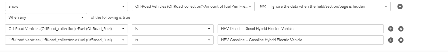

For kickers here is the field rule I had in place prior that worked, but the end users didn't like the single line displaying all their options because they had to clear the line to see the other options.
