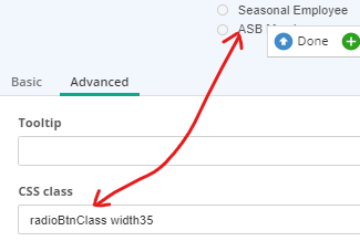

  • I tried your code as is (no changes) with the radioBtnClass in the Advanced tab of the radio button field and the hiddenFieldClass in the Advanced tab of the field with the default value
