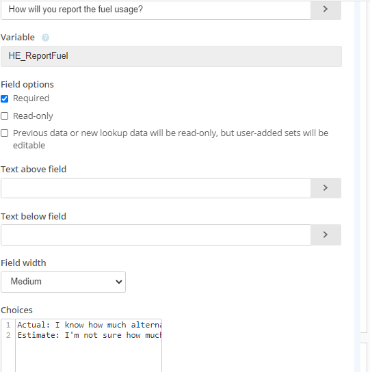

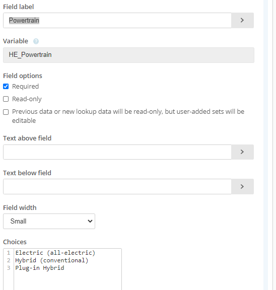

Hey Jason, Thanks for the advice. I am trying to implement this and keep getting a syntax error in my formula. Also, I assume this field is meant to be a number field since it is the only field that contains the calculation option.
Here is what I have : =OR(HybridElectric_Vehicles_Collection.HE_Powertrain.Hybrid (conventional),AND(HybridElectric_Vehicles_Collection.HE_Powertrain.Plug-in Hybrid,HybridElectric_Vehicles_Collection.HE_ReportFuel.Estimate: I'm not sure how much alternative fuel was used.))
*The bold text above represents the value of the options in the drop down lists.
Below are references from my process.
  • HE_Powertrain
  • HE_ReportFuel
replied on January 20, 2021

replied on January 25, 2021
There's a difference between the visible text for the choice and the "value" of the choice. The "value" is what should be in the calculation.
Did you type those values in manually, or did you select them from the variable dropdown menu (the > button above the calculation field)?
Under the list of the choices there's the "Assign values to choices" checkbox; I'm not sure if you need that enabled, but that's how you'd set values manually.
I try to set shorter values, for example, although your choices are "Actual: I know how..." and "Estimate: I'm not sure.." I would just set the accompanying values as "Actual" and "Estimate"
