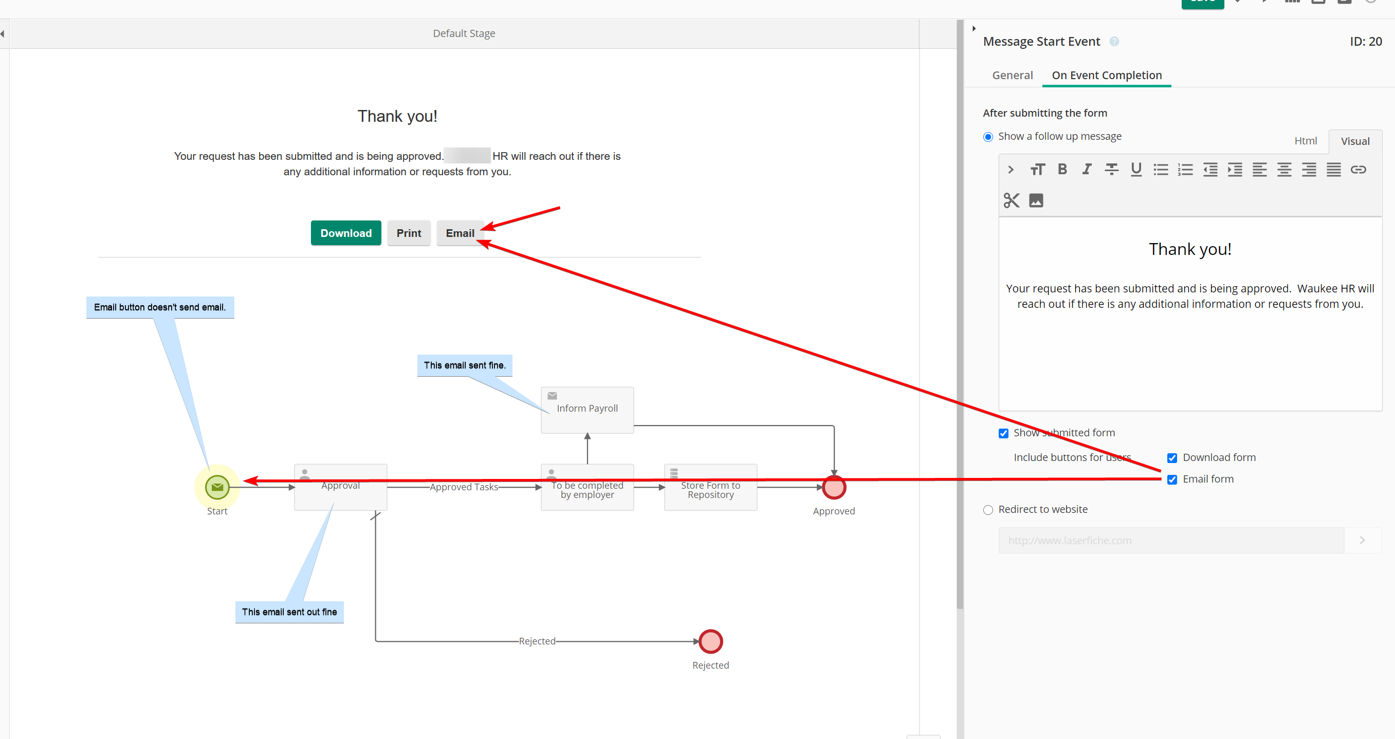

I just created a simple approval form. I've checked my configurations and emails are sending fine (as the approval emails are being sent after the form is submitted). However, I had trigged the option at the starting form that on the event completion, show the download and email buttons. This should allow users to download the form, a print option also appears, and the Email button.
Unfortunately, when the Email button is pressed - no emails are sent out.  I've turned on debug diagnostics settings in Forms Config. I do not see any errors or issues on the windows server event log in Forms. It seems to only impact this condition and at the starting point. Email delivery is fine when an email service task is initiated or other processes that are down the line in the form's workflow.

Per your question, yes - the download works, and the print button works.  Email is the only one out of the three that does not work.
The entire form is set to email my AD/Exchange account as I'm still testing it before publishing. From Start to Approval, to Inform Payroll stages - it is programmed in to inform and assign my AD account. When the Approval and Inform Payroll stages kick-off, I do receive email notifications of those processes - so I know email is working properly.
I've also verified our exchange server is relaying emails for both the DMZ-Forms and the Forms server. Worked fine when testing it in FormsConfig by sending out an email test and is evident by the kick-off of the task assignment in Approval and Payroll email service notification.
To make sure, I also inserted a field that did a lookup for the initiator user in the starting form and it is pulling in the correct email address for my account that submits the starting form.

As for your inquiry regarding the button - The button does depress like the Download/Print when struck. It just doesn't do anything (including not bringing up an email client or a window prompt).
I also thought it may be a browser issue, but it's reproducible on Edge (Chromium) / FireFox ESR 78.6.0 / Chrome 87.0.4280.66 - which should address your browser cache question (but I have also done the CTRL + F5, just to cross it off the list).
Since I configured the SMTP client timeout (in seconds) for 200 seconds under FormsConfig - I thought that may have something to do with it. I proceeded to reduce the timeout to 1 and retry. The same issue persisted.
