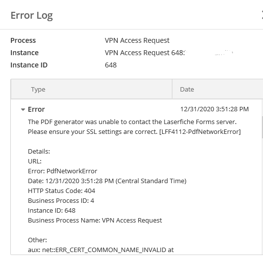

I am getting an error now when my Forms are trying to write to the Repository from the "Save to Repository Task".  Several Forms, not just one.  The error from the "View Logs" shows this below:
Error Log:
The PDF generator was unable to contact the Laserfiche Forms server. Please ensure your SSL settings are correct. [LFF4112-PdfNetworkError]
Details:
URL:
Error: PdfNetworkError
Date: 12/31/2020 3:51:28 PM (Central Standard Time)
HTTP Status Code: 404
Business Process ID: 4
Instance ID: 648
Business Process Name: VPN Access Request
This is new since we did the update last week.  Please tell me how to correct this issue.

We just did server migrations for our databases a week or so ago, and our Certifications are not valid at the moment, could that been the issue? My Profiles are working fine.

What does the part of the error message mean when it says: "The PDF generator was unable to contact the Laserfiche Forms Server", what is the PDF Generator????
replied on January 4, 2021
The PDF generator is the tool used to take the web form and turn it into a PDF that is then saved into your repository. Based on the configuration in the save to repository task, it requires SSL to pass the generated PDF to the repository as part of the process. If your SSL certificates are invalid, this connection may be interrupted and prevent saving forms to the repository from working.

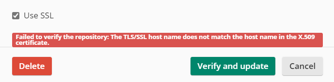

We have gone through our Certificates and still not resolving this issue.  I noticed there is a check box on the Save to Repository Task for Profile called "Use SSL".  I have never checked this box to use this and not sure if it is newly added or not, but when I do check it and try to verify and update I get this message:
What does this mean?
