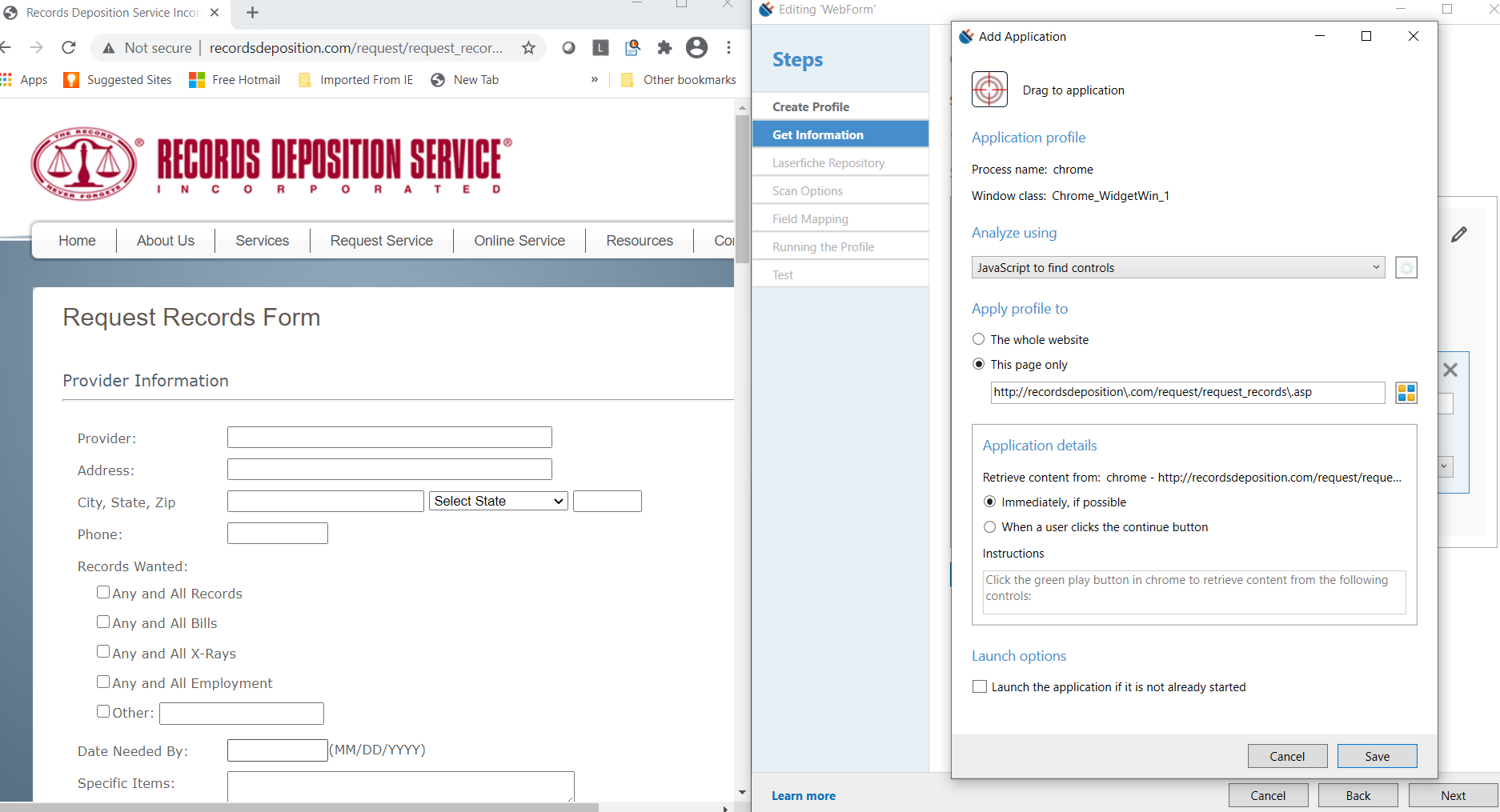

I have configured a profile to work with a submit form in IE and everything works as expected.  I have tried adding Chrome with issues.  I have run the Chrome Configuration Utility and am able to to get the URL using UI will not work with Java.  When I try to create a token it will not focus on the target area.  It grabs all text for the entire page.

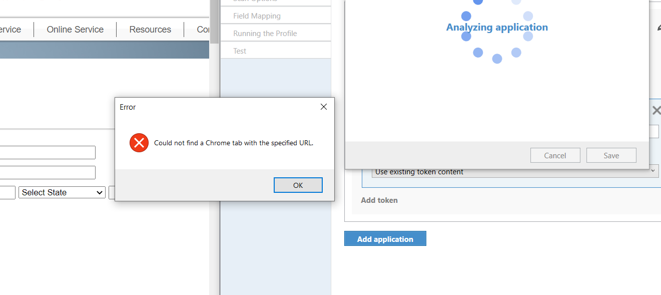

I have run the utility per your instructions when analyzing application I still get error "Could not find Chrome tab with specific URL. See attached screen shots

Have you tried to configure UI Automation manually? The utility is designed for using the Javascript method, and cannot configure to use UIAutomation correctly, that's why "it will not focus on the target area. It grabs all text for the entire page." when you use UI Automation. Therefore, please configure the --force-renderer-accessibility parameter following the online help file, and then try to analyze application by UIAutomation.
If you'd like to use the Javascript method, I'd recommend you to create a support case, and attach the screenshot of error message, the profile and log files to the case.
