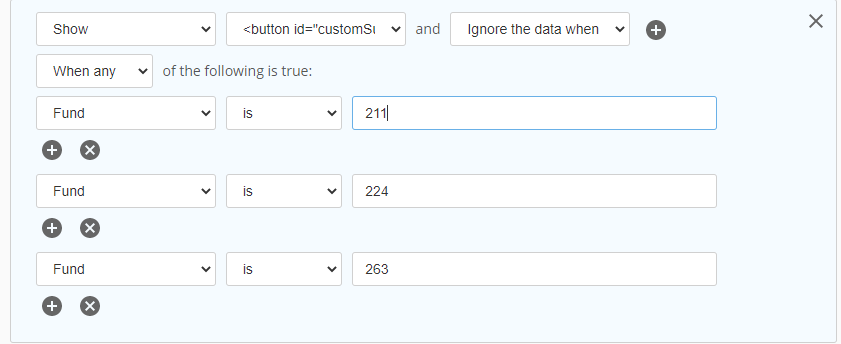

Am designing a form where the fields are populated based upon look rule.
One of the field is called Fund.
If the value of this field is any other value other than 200,201,202 i need to display a message "This form is only for employees with Fund Code 200,201,202" and disable the submit button or hide the submit button.
Below is the code is have for 1 condition. Need advice on what is incorrect and how i can handle all the 3 check. Can it be done in 1 if statement for all 3 checks (200 or 201 or 202)
$('#q6 input').change(function(){
      if ($('#q6 input').val() != 200)
      $('.Submit').hide();
      $('.submitMsg').hide();
      $('.Submit').prop("disabled", true);

Rather than trying to write JavaScript, I usually do this:
  1. Set CSS to always hide the built-in submit button
    • .Submit {display: none !important;}
  2. Add Custom HTML with my own submit button
    • <button id="customSubmit" type="submit">Submit</button>
  3. Add CSS to style it as needed
  4. Use Field Rules to show/hide the custom submit button
I do a lot of custom JavaScript, but for something like this it isn't entirely necessary and you get a lot more control when it's your button rather than the one added automatically.

I was testing the process after making the above changes and when i click submit to submit the form with my test data, it gives an error
Laserfiche Forms has encountered a problem.
An unexpected error has occurred. [LFF502-UnexpectedError]
This is what i did.
In CSS, i did
.Submit {display:none;}
In the forms i created a custom html to display Submit button.
I then control this through the field rules.
Any idea why the custom built Submit is causing this error.
replied on December 17, 2020
Hard to say for sure without additional testing, but the easy solution is to fall back on a "tried and true" method as a quick fix.
Change the type from "submit" to "button"
Then add the following JavaScript
$(document).ready(function(){
    $('#customSubmit').on('click',function(){
        $('.Submit').click();
Basically, instead of instead of trying get the custom button to work as the submit button directly, that JavaScript makes it so the click event on the custom button just triggers a click event on the hidden Submit button.
replied on December 18, 2020
Perfect! Added the click event and changed the type to button and it worked as expected. Thanks again!
