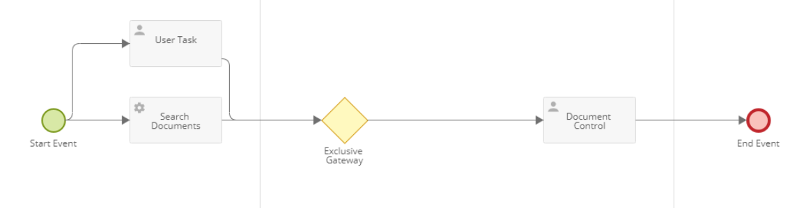

I'm not sure if this is even possible but can you merge data from a workflow's set business processes using a gateway?
I have a workflow that I want to run before I show the form but I don't want my users to have to go to their inbox to select it after they have started it, so I created a blank form that will submit itself after a few seconds and added a merge gateway to merge the data without creating two document control forms but when I get to the document control form the data is not there.
is it even possible to merge data from a workflow? and if so how?
I have tried multiple combinations of gateways to try and get it to work but I never get any data from the workflow on the form. any help would be appreciated.
Thanks,
Aaron M.
replied on December 3, 2020 • Show version history
Gateways don't merge "data" they merge process flows. In the screenshot you provided the two processes are running in parallel so the User Task would still be created without the updates made in the workflow service task step.

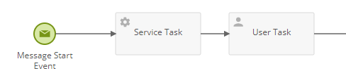

You can put a workflow service task directly before the user task without interrupting the flow so that the user task isn't started until the workflow is done making the necessary updates.
You just need to make sure:
  1. the workflow doesn't take too long to avoid timeouts (not sure of the exact time but it's long enough for most things)
  2. Set Forms to wait for the workflow to complete before proceeding
  3. check "automatically load the next task..." in the Start Event
I do this on a few of my processes where I need workflow actions to be performed and it still automatically redirects the user to the next task once the workflow completes.
When it is set up this way, the initial submission would trigger the workflow, the page would show as loading/processing while the workflow is running, then when it is finished it would open the user task.

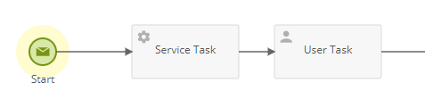

Sounds like you'd need a Message Start Event in that case. Unless I'm mistaken, if you use a standard Start Event, there's no starting form submission so you can only start the process from the Start Process page in Forms or via Workflow.
Because there's no starting form, there's no option for "Automatically load the next task" which seems to track with the issue you're having.
replied on December 9, 2020
While I do want the form to open immediately I still require the workflow to run first and using a message start won't let me run the workflow first.
In that case it's kind of one or the other. One "workaround" would be to create a separate starting form, use the Message Start Event, but add some JavaScript to the starting form so it submits automatically when the document ready event fires.
If you do that, when they open the form it would auto-submit, they'd get a loading view while the workflow runs, then it would load the task after the workflow completes. That's probably the only way you could get both things to happen.

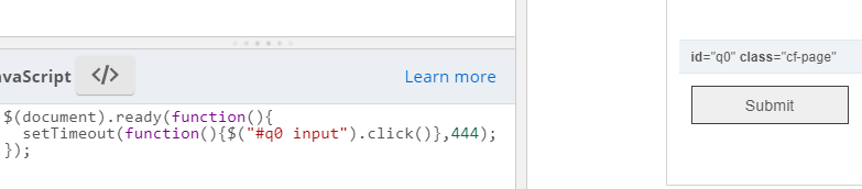

I thought that would work as well but when I have that JavaScript in the message start event form it does not submit. It works fine in a user task just not in the message start event. Maybe I am submitting it wrong as I am just calling the onclick event of the submit button? see code below.
That's likely the problem, the submission/action buttons for a user task are not exactly the same as the ones added for a starting form.
Just use $('.Submit').click();
I don't think the timeout is necessary either.
Even if you have lookups or something, you can just set the submit click to trigger when the onloadlookupcomplete event fires instead of document ready.
Its just an empty form so it should be fine to just submit that way. I can't get it to work without a slight timeout on the forms, not sure why but the functionality is there.
