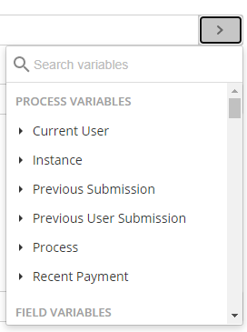

I can't access any of the variables listed as Process Variables for anything.
With the exception of Text above field where I can see there are Process Variables available they never show up when I go to use them in a Calculation or Field rule. How can you even use these variables if you can never access them in any logical condition?

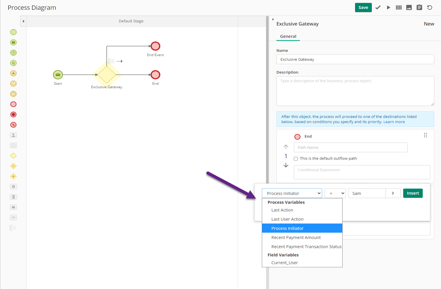

Process Variables are most commonly used within the Process Designer layer, where they are readily accessible to use in conditional statements.

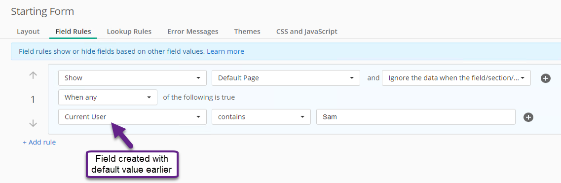

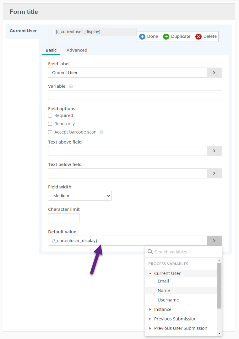

To use a Process Variable within a form layout, create a field and set its Default value to the desired Process Variable like so:
Make the field Read-only if desired.

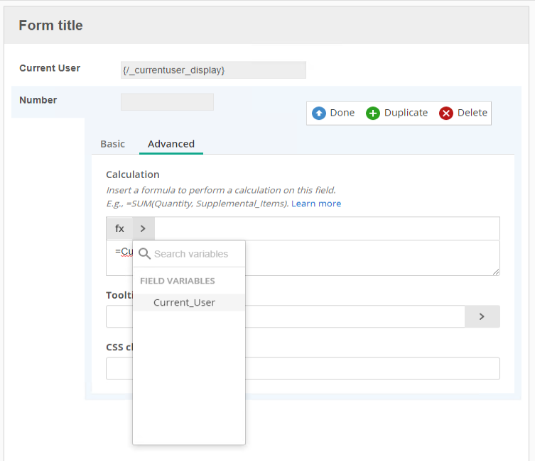

This creates a Field you can use for Field Rules and a Field Variable you can use for Calculations.
Field Rules:
Calculations:
