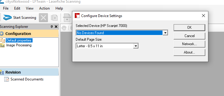

replied on November 23, 2020
Thanks for the response. Unfortunately, I am not getting that Scan Sources option when opening up Laserfiche Scanning. Attached is a screenshot of what I am getting when opening up the scan option in laserfiche. Is there a different way I need to be connecting the Scanner?

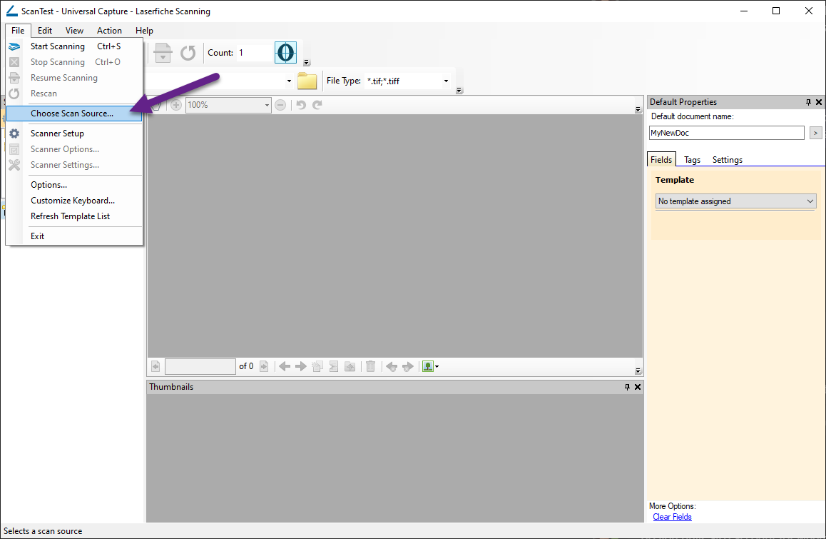

replied on November 23, 2020 Show version history
Ah, the Scan Sources dialog automatically up the first time you launch Scanning and then saves your settings. You can always get back to it from "File -> Choose Scan Source".
I'm not that familiar with the "Configure Device Settings" options, but it looks like you might already be connected to the scanner in question (says Selected Device: HP Scanjet 7000). Unless that's the previous "s2" one?

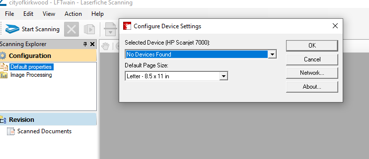

replied on November 24, 2020
So when I try and click Okay, Cancel or even close out of the Configure Device Settings pop up all I get is an error box "Cant Talk to scanner, Check cables and Power. (-4432). If I click on okay or close out of that pop up box it just gives me the original pop up Configure Device Settings.  I cant click on anything on the Scanning page. So it won't let me get to File and Choose Scan Source. Any other suggestions?

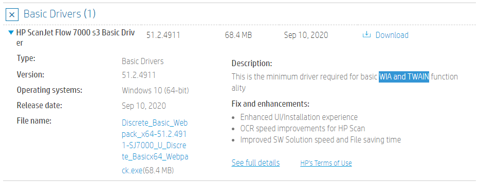

Did you install the Twain driver for the scanner?
Do you have an available ScanConnect license?  If so install Scanconnect and use the ISIS driver.
replied on November 24, 2020 Show version history
I don't see a Twain Driver option on HP Website for the scanner. Here is the URL for the driver I downloaded for that specific scanner. https://support.hp.com/us-en/drivers/selfservice/hp-scanjet-enterprise-flow-7000-s3-sheet-feed-scanner/10431055
Also, I don't believe we have any ScanConnect license. Is there a way we can see if there is a ScanConnect License?
As @Burt Warren mentioned, the TWAIN and WIA (also supported) drivers are part of the Basic Driver (and presumably "Full Feature Driver and Software) package.
