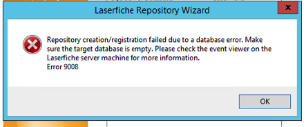

Repository creation/registration failed due to a database error. Make sure the target database is empty.
asked on November 19, 2020
This is a brand new install. LaserFiche Directory server is installed. LaserFiche Server is installed. Creating the repository on the SQL express instance and at creation we get this error attached. Event Viewer says it needs .net 3.5 but we have that installed. still get same error.
sql lf error.png (37.69 KB)

Identified issue :
When creating repo --> Laserfiche Specific settings-->Initial volume Settings -->location: Under the Laserfiche Files directory(option should be selected )
I was using second option and explicitly providing the path which was similar to the above
replied on September 14, 2023
9008 is a generic error indicating the specified SQL database was not reachable. The Laserfiche Server event log should have a more detailed error message indicating what went wrong.
