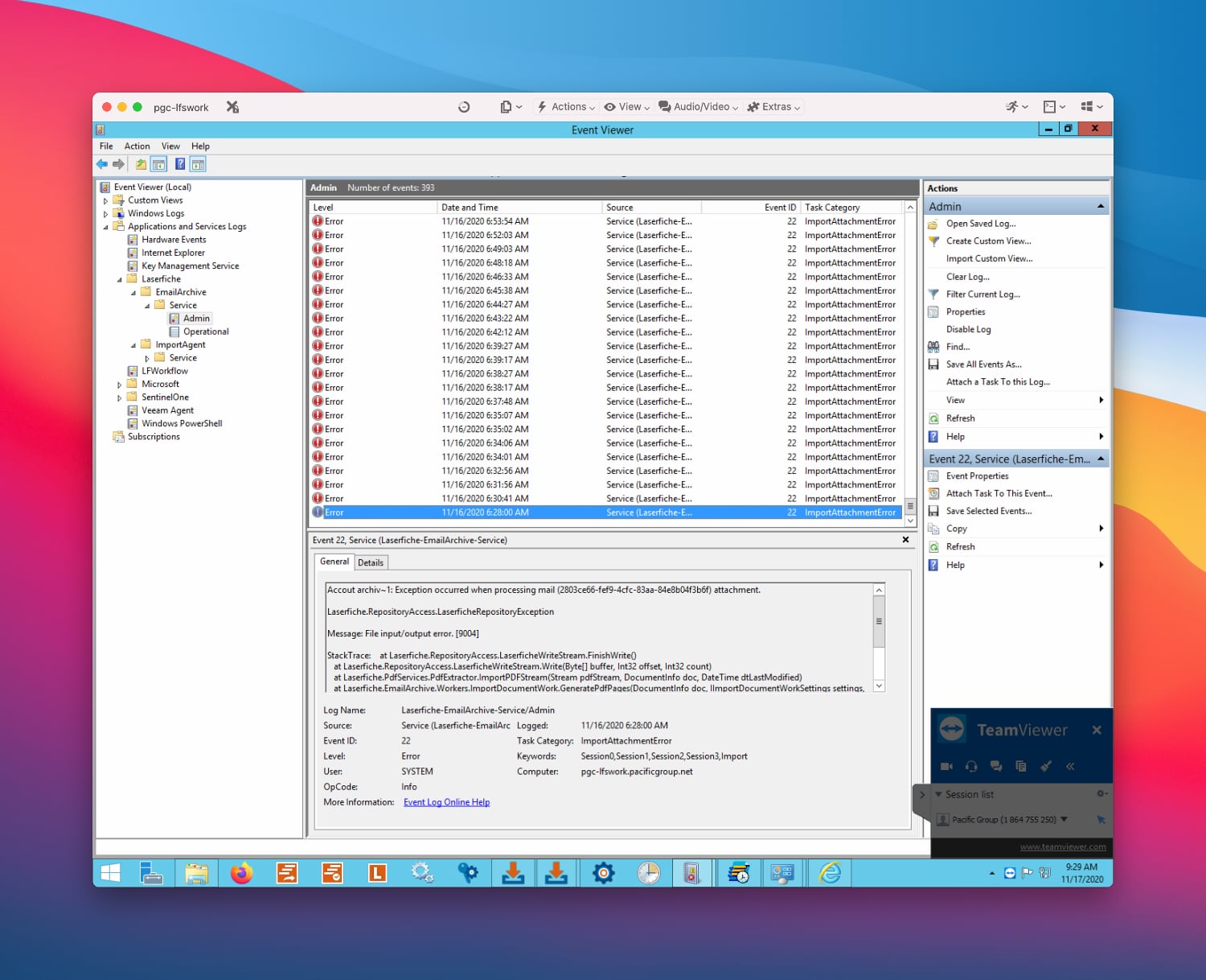

Looks like the emails may simply be lost - seeing error in Event Viewer, screenshot attached.

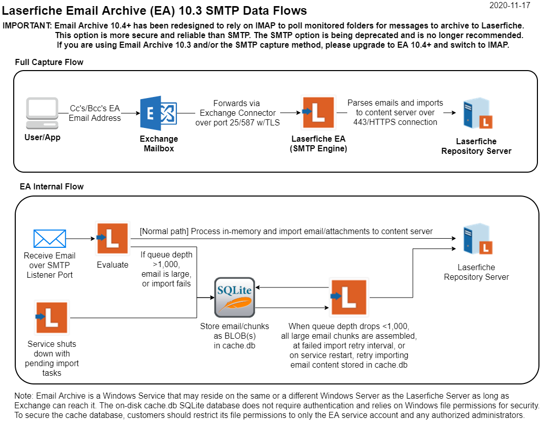

Email Archive has an internal queuing mechanism. If the target repository is unavailable, EA should write emails to disk and periodically retry sending them. You shouldn't lose emails from the repository being offline. However, you can completely lose emails if Email Archive is offline or otherwise unavailable at that time.
For that and other reasons, we re-architected how Email Archive works in 10.4 to use IMAP instead of SMTP. Rather than trying to catch emails Exchange throws at it, Email Archive connects to a mailbox via IMAP and downloads unprocessed emails in that mailbox. This is a much more resilient and secure architecture that avoids known data loss scenarios possible with the old SMTP method, which we are depreciating.

replied on November 17, 2020
Thanks - is there a folder on the server that shows the spooled email?
I attached what we are seeing in Event Viewer.
replied on November 17, 2020 Show version history
They're stored in a local sqlite database rather than as files in a folder. The "File input/output" error you're seeing there seems to be failing on PDF page generation though. If you look at the stack trace, the last two visible lines in your screenshot are:

For your knowledge, I've also attached a diagram showing how Email Archive queues messages.
Screen of event viewer

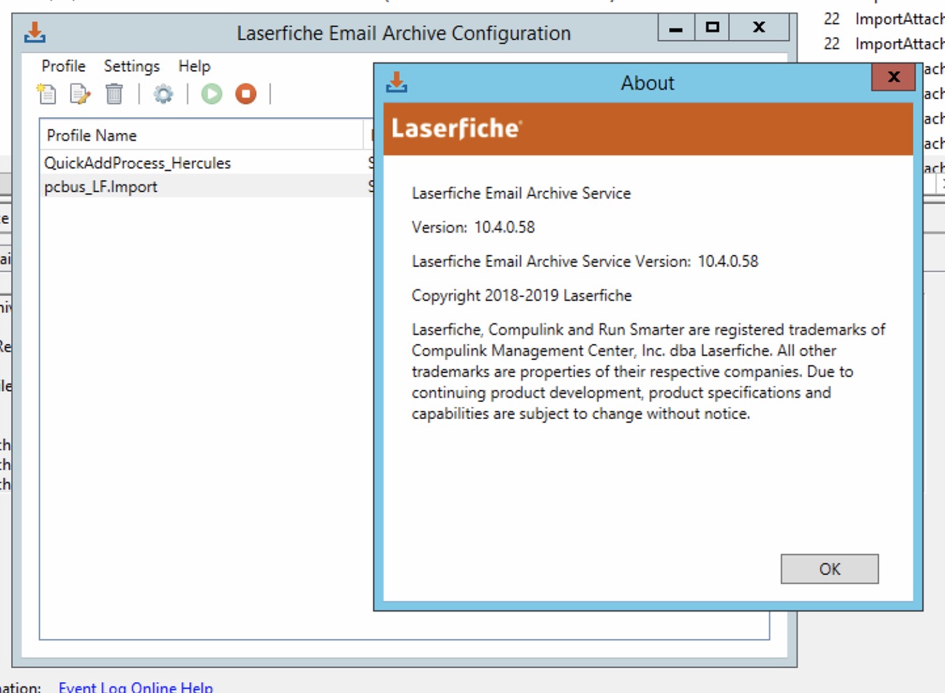

replied on November 18, 2020
We are on version 10.4, see attached.
Also - this looks like it should work, however we have many missing emails (100s) over a period of a few days when the LF Target Repo was offline (san disk offline - LF server was running but the repo disk was offline).
We do see errors in event viewer, but spot checking files that should have queued, it appears they are lost.
These are PDF files, that we are storing.  The issue is a IO error, which makes sense as the target repo disk was offline.
Here is a sample from the event log:
Log Name:      Laserfiche-EmailArchive-Service/Admin
Source:        Laserfiche-EmailArchive-Service
Date:          11/16/2020 6:39:27 AM
Event ID:      22
Task Category: ImportAttachmentError
Level:         Error
Keywords:      Session0,Session1,Session2,Session3,Import
User:          SYSTEM
Computer:      pgc-lfswork.pacificgroup.net
Description:
Accout archiv~1: Exception occurred when processing mail (2d568cf2-a724-4db0-9c4c-f627e82b675e) attachment.
Laserfiche.RepositoryAccess.LaserficheRepositoryException
Message: File input/output error. [9004]
StackTrace:    at Laserfiche.RepositoryAccess.LaserficheWriteStream.FinishWrite()
   at Laserfiche.RepositoryAccess.LaserficheWriteStream.Write(Byte[] buffer, Int32 offset, Int32 count)
   at Laserfiche.PdfServices.PdfExtractor.ImportPDFStream(Stream pdfStream, DocumentInfo doc, DateTime dtLastModified)
   at Laserfiche.EmailArchive.Workers.ImportDocumentWork.GeneratePdfPages(DocumentInfo doc, IImportDocumentWorkSettings settings, IImportDocumentSource source)
   at Laserfiche.EmailArchive.Workers.ImportDocumentWork.ImportDoc(DocumentInfo doc, IImportDocumentWorkSettings settings, IImportDocumentSource source)
   at Laserfiche.EmailArchive.EmailExecuteJob.AttachmentDistWrapper.CreateAttachments(LfAttachmentCollection attachments, ICreateDocumentWorkParameters emailCreateDocParameter, IImportDocumentWorkSettings importSettings, AssignMetadataWork assignMetaWork)
