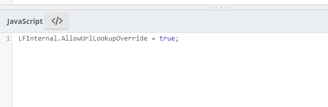

Actually Forms already support passing values for variables in URL for user task already, it is just turned off by default, you need to add " LFInternal.AllowUrlLookupOverride = true;" in the JavaScript for the form used in user task as following to turn it on:
We will turn it on by default in next release.
replied on November 26, 2020
Thanks Xiuhong, this is awesome!
