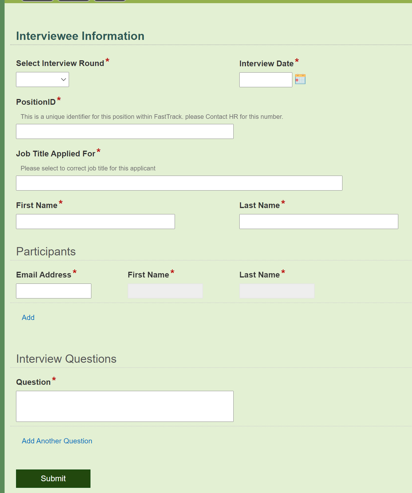

Clear a field variable after submission
asked on November 2, 2020
I have a Interview participants form that once submitted, goes to a workflow to do some magic then gets reassigned to the initiator to fill it out again for round 2, 3 etc of interviews .   I have a drop down that they select what round of interviews it is.  What i would like to do is when this form gets reassigned to the initiator, reset that "Round" dropdown to blank since it is a required field.   If i leave it the way it is now, it retains the last value that was used which i do not want.  (Note: i do use the number from the "Round" in the name of the docs being saved to the repository)

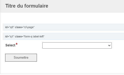

Hi Marce,
You can use Javascript
//Document is ready
$(document).ready(function ()
  		//Set select value to nothing
  		$('#q1 select').val(0);
3 0
replied on November 5, 2020
Thanks Olivier!  this worked great!!  Now, if i also want to clear the " Question" multi-line field on that form what would i add  to the js?
replied on November 13, 2020
add after line 5
$('#qx textarea').val(''); //Replace qx by your question's id
