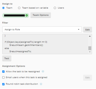

I have an interesting scenario for team filters that I cannot figure out. Here is my script as an example:
var checkRole;
var assignedTo;
checkRole=$util.getValue('Role');
if(checkRole=='Available')
assignedTo=team.findMembersByRole(checkRole);
//In case no team members Available, assign to whole team
if (Object.keys(assignedTo).length == 0)
$result=team.getAllMembers();
else
$result=assignedTo;
In this scenario, if there are no users assigned to the "Available" role, then I have a catch all that assigns to the whole team. However, I have Round Robin distribution enabled as well.
The end result is that it randomly round robin distributes the task within the whole team, even if the user is not in the role I'm searching for.
My desired result is to rather assign to the whole team without round robin, so that it goes to Unassigned Tasks instead. My challenge is that under normal circumstances when the "Available" role is found, it needs to still Round Robin distribute.
Is there a way to achieve this via the Javascript filter or some other method?

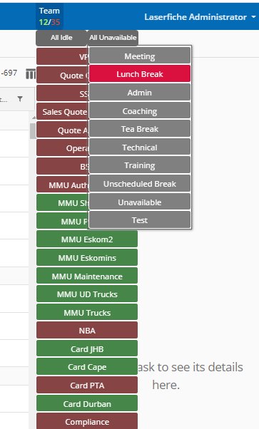

We've developed a custom plugin to allow users to manage their roles. My administrator account is part of many teams in the screenshot below, and as you can see, some teams are green. Green means you're Idle (Same as being available or not OOO). Users can quickly update their status within all the teams in one go and specify that they're on lunch, unavailable etc. We then record their selected option in a SQL Table with a timestamp in case any reporting is required to be done on the user's role assignments and how long they were in a particular role for that day.
The challenge still comes in when you want to round robin assign tasks to users to even out the workload, the team filter still round robins based on the final result. I'm going to try out Ziyan's suggestion as well to see if it works. However, what I'm really looking for is that "feed one task at a time" feature. I think we're going to hack away at the Forms API, documented or not, and see if we can find a solution to this. Will be sure to update everyone here of the outcome.

Hi Sheldon,
Is it acceptable to you that task is randomly assigned to Available team member?
If yes, following alternative may work:
Uncheck 'Round robin task distribution' option, so that task won't be assigned to specific team member in all scenarios.
Then try to achieve 'Round robin task distribution' in team filter. I use random function here
var checkRole;
var assignedTo;
else
//random assignment to member
var pos = Math.floor(Math.random() * Object.keys(assignedTo).length);
$result=assignedTo.slice(pos, pos+1);
