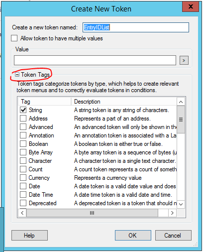

I think in workflow you can define token type
make it integer only so you won't get string.

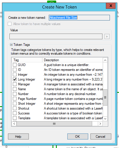

Unfortunately that approach didn't work. In this instance I have set it to a long integer to match the datatype returned from the TotalFileSize property:
And it still converts it to a string:
