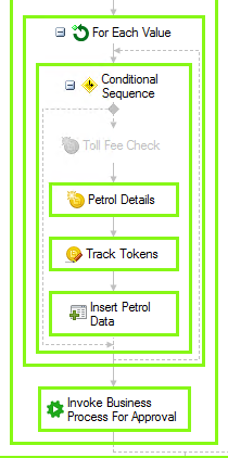

We have a process that Inserts data into a SQL table. Once complete it invokes a Business Process Form.
With both tasks Enabled, the tasks show they run successfully with the Form being created. Except no data is inserted into the SQL table.

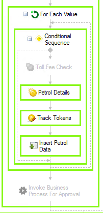

When we disable the Invoke Business Process task and rerun the process, the data is inserted as it should be.

Activities are executed sequentially. Are you sure your Forms process is not triggering some other workflow instance or Forms process that cleans up the value from your table?
replied on October 26, 2020
Hi  Miruna,
Not that I can see. I have the attached the two instances. All that changes is the disabling of the task
Oh, there's loops involved. Did you confirm you're running the same number of iterations in For Each Value and the same number of Conditional Sequences?
