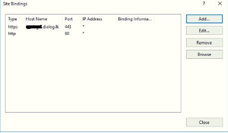

I have deployed both Forms and Workflow in an AWS instance. We wanted the clients to connect to the forms using the domain name with SSL. The domain name is bound to the IP of the AWS server. So in our IIS bindings for default site we have setup the bindings as follows,
Now the Forms can be accessed in the browsers using https://*.dialog.lk/forms and workflow can be accessed in the browser as https://*.dialog.lk/Workflow as well.

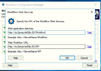

But in the Workflow configuration manager I am unable to make a successful connection using https. Instead it connects using the FQDN of the machine using http.

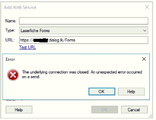

And also when I try to configure a workflow web service from the workflow admin console I am getting the following error message.
I want both Forms and workflow to work with SSL. What am I missing? Can someone please guide me?

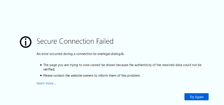

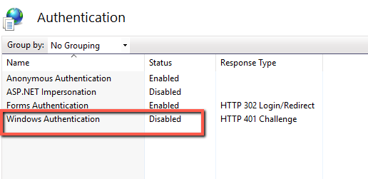

First, you should not be prompted to provide the windows credential when access https://{FormsServer}/Forms/api/help ((replace "{FormsServer}" with the Forms server  machine's FQDN) as Forms website should not have "Windows Authentication" enabled, you can check the Authentication from IIS Manager->Sites->Default Web Site->Forms->Authentication:
Second, for the "Secure Connection Failed" issue, you can check whether you can access https://{FormsServer}/forms (replace "{FormsServer}" with the Forms server  machine's FQDN) from the Workflow Server machine first? If not, you need to fix this first before configure the Workflow web service.

Ok I disabled windows authentication on IIS for forms and now I see this page.

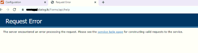

You should use your domain name to access if the certificate of HTTPS also use domain name. Have you configured the Workflow Server on the Laserfiche tab of Forms? If yes, you can uncheck "use SSL connection" under Primary Forms Server URL and then check it on Forms Server tab to enable the save button and save the settings again, then test access the API from the browser. If you still get error, check the detail error in event log.
replied on October 26, 2020
Yes our SSL certificate is issued to the domain name. I have configured the workflow server connection in the Forms configuration page with SSL enabled. I restarted all services but I still get the request error. Also on the event viewer I see "Service unavailable because the Workflow Server is not configured in Laserfiche Forms. Please configure the Workflow Server in the Laserfiche section of the Forms Configuration page. [LFF5206-WFAPIAccessDenied]"
But I have added the workflow server in Laserfiche Forms configuration page I got a successful message as well.
What am I missing?
You have refreshed the page to make sure the Workflow Server is saved correctly? If you have make sure the Workflow Server on Forms is correctly configured but you still get error message when access the API, you can open a support case and provide the screenshot of the Laserfiche tab and access the API page and provide additional information of your network if there is anything special for the network setup.
Forms compares whether the IP address of the configured Workflow Server matches the IP address of the incoming request to access the API to determine whether you can open the API page. Some special configuration for network may affect the comparison.
