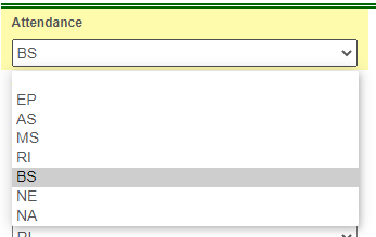

We have an Evaluation form that has a grading scale for areas that are being evaluated. Each field for the area of evaluation, is a dropdown that has
Some areas being evaluated:
  • Attendance
  • Compliance
  • Dependability
  • Driving
Grading scale is as follows:
  • EP (Exemplary Performance) = 5
  • AS (Above Standard) = 4
  • MS (Meets Standard) = 3
  • RI (Requires Improvement) = 2
  • BS (Below Standard) = 1

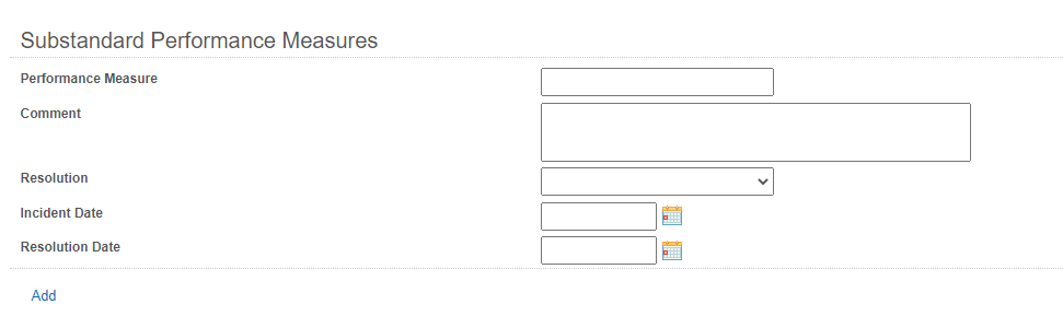

The goal is to have a separate collection called Substandard that will list all the areas being evaluated that have a value of 1 or 2. For each area there will be a range of collections that autofills what area has a value of 1 or 2.
For each area that is substandard, it would create additional collections to document what needs to be worked on. Please help...

There are a few way you can approach this, most will be kind of messy imo but should be possible with jQuery. Roughly speaking what you need to do is set a onChange listener event on the gradescale inputs. In that onChange function you'll need to:
  1. Check to see if the new value is a grade 1 or 2, if it is continue otherwise do nothing
  2. Simulate a click on the "add" link for the collection using the click jquery function.
  3. Grab a reference to the substandard collection, and find the last collection item.
  4. Auto fill what ever fields you need filled in on this collection item.
The roughly outlines one approach, and if you can get that to work then next you'd likely want to be able to undo all that if say the user decided to change their mind or accidentally selected a 1 or 2. The steps will be very similar. Hope this helps!
