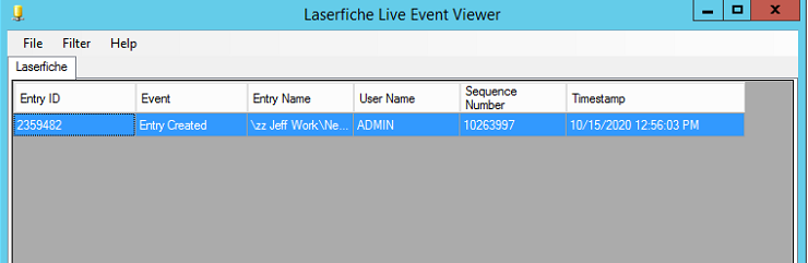

Is the service that monitors Live Events different from the service that monitors for start and wait conditions in workflow. I noticed that if I monitor my event with the live monitor and I don't see that same event in the Trace Log, then my workflows with conditions for that event will never have a trigger.

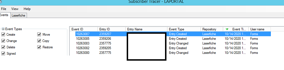

Here this event doesn't show up in the trace, along with any  other events from 10/15 because whatever handles the trace log is not working while the live log is.
The reason this confuses me is if I am troubleshooting whether or not the subscriber can see events in the repository, the  next place I go after checking the trace, is the live, but everything looks good in the live so there is a disconnect between the 2.

The Live Event viewer is all the notifications the Laserfiche Server emits while the window is open. The Subscriber Trace will only show the events the Subscriber evaluates.
Your Subscriber seems to have stopped on the 14th at some point. Click on the "Laserfiche" tab over in the Subscriber Trace and see if it's still connected to the repository properly.

Ok, so the live log is data in the Server Service itself. Which explains why it doesn't have to match the trace log and why subscriber can be offline for it to work.

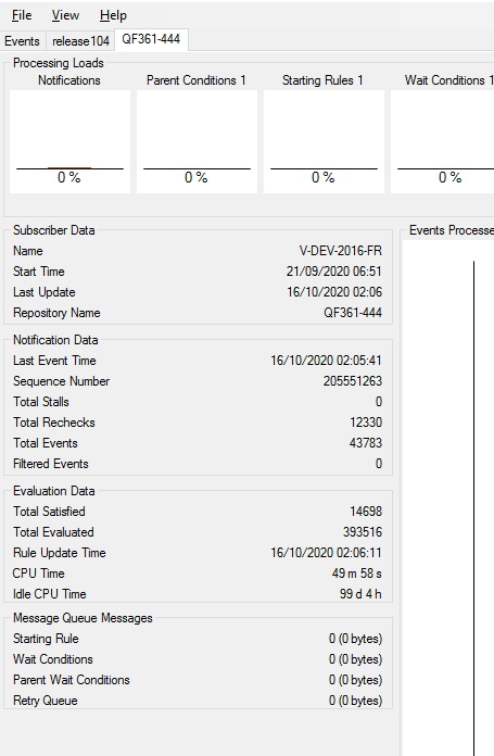

What does the repository tab show in the Subscriber Trace?
replied on October 15, 2020
Well everything looks good now since I took these screenshots before restarting the service to resolve the issue but next time I will look here. What would I look for though, I expect I will see the last event time will be out of date but I can already see that from the last event in the Events tab.
Maybe here I would see the Queue building up?
It depends. If there's a problem connecting to the repository, it will have a warning icon at the top in the "Processing loads" graph. Clicking it will tell you what the error was.
The rest of it might tell you if the problem is actually with the Subscriber or something else. You would see things like when it last got a list of updated rules from the Workflow Server, when it got its last event from the repository, whether there's a backlog of messages to process.
