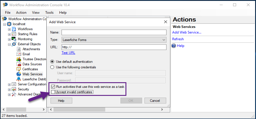

There are only a few places in the Laserfiche suite where you can even toggle accepting invalid certificates. One such example is for Workflow connections to external web services:
Unless an option to accept invalid certificates (which includes certs from untrusted certificate authorities) exists and is explicitly enabled for the connection you're trying to make, assume any certificate validity issues will be fatal.
You should try adding that self-signed server cert to the client machine's Trusted Root Certification Authorities certificate store. Validate that Chrome/Edge/IE no longer throw any warning about any aspect of the certificate, then try the Laserfiche connection again. Firefox uses its own certificate store and is thus not useful for this test.

replied on October 20, 2020
Thanks for the update, Chad.
In Robert's initial update, he mentioned that LFSO tracing can be used to further debug the issue. From the LFSO trace that you sent to LF Support, it showed that you were getting a WinHTTP 12175 error. From https://docs.microsoft.com/en-us/windows/win32/winhttp/error-messages it states that 12175 means
One or more errors were found in the Secure Sockets Layer (SSL) certificate sent by the server.
Despite that being the only real detail MS provides without going deeper to check the callback status, there are only really a few things about the certificate itself that could cause an issue. Those things were also outlined in Robert's reply and it turned out that the issue was the first thing he suggested checking, which is the hostname being used and making sure that matched up with what the SSL certificate will accept. Keep in mind that this is the certificate's subject or subject alternative name. The friendly name is only meant to help someone identify a certificate easily and has no actual bearing on the usage of the certificate.
