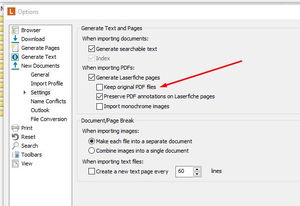

When importing a PDF, you can import and drop the PDF by default, by setting the following in options:-
This will by default, convert any incoming PDF to TIFF and drop the PDF.
Hope this helps!
