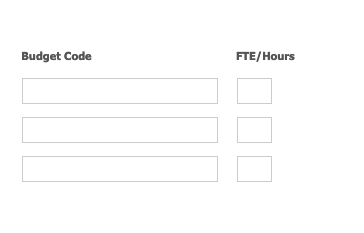

I have a table in Laserfiche Forms with two columns and three fixed rows.
The variable assigned seems to be only set for the columns on the first row?  Is there a way to obtain the variables for the two other rows?

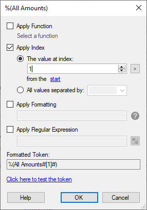

Anywhere you're using a token you can right-click to get the Token Editor, then tell it which value to use in the Apply Index area.

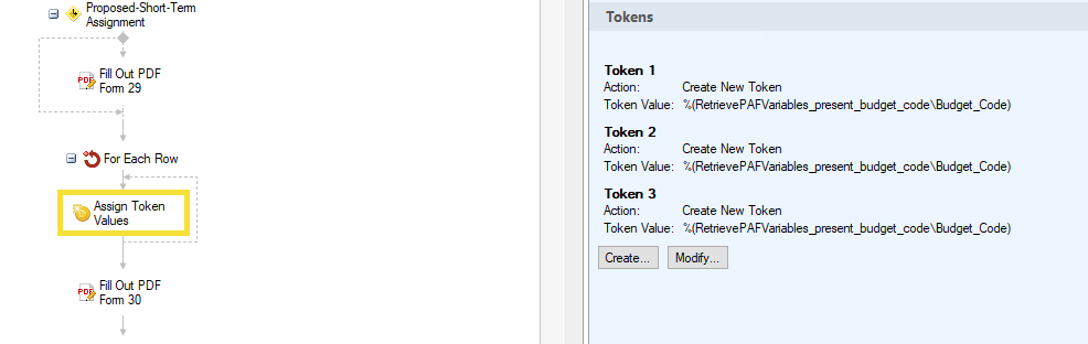

Depending on what you're doing, Workflow can also get at them. Typically you would use a For Each Row to loop through the table but you can also use the variable itself and then, with the Token Editor, tell it which value (row) to use. The one thing is you have to know how many rows the table has to use that second method effectively.
replied on October 13, 2020
Is the token editor the "Assign Token Values" tool?  I have it set up like this but it isn't working.
Thanks so much!  It works great.
