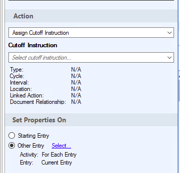

We can do this manually in the Web Client with no trouble. However, we are not having any luck with workflow.  We have tried the RM Task to set Cut Off Instructions, leaving the value blank:

Well, I solved half of the problem. The WF rule using Records Management tasks was running without error but did not appear to do anything.  But, it was. The problem is that the sort order can be slightly different between the search results and what you see in the client, especially when using an alpha sort. The trick is to limit your search to a single entry. Then, you can track that entry by ID and confirm that the change you want to make has been made.
In terms of the above, enabling a Cut Off Instruction with no value selected removes a prior Cut Off Instruction.

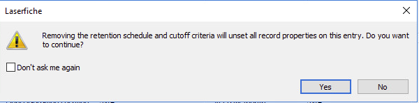

In the client, you can do this:
And get this warning:

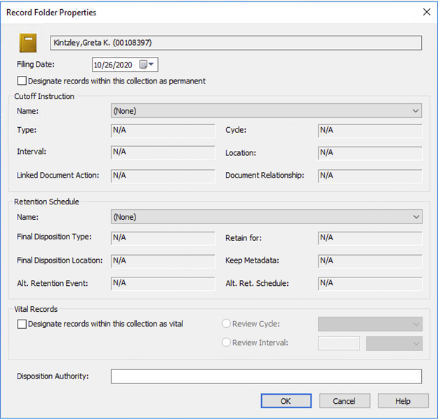

Which turns the records folder:
back into a regular folder:
where we can reapply the records properties we need.
