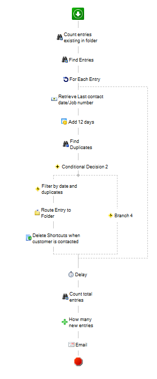

replied on October 9, 2020 Show version history
Thanks for the suggestions.
After some thinking, I decided against actual notifications since we can have a couple hundred retail customers at a time. I opted for putting shortcuts to the job folders in another folder. The workflow scans all retail jobs and filters the the ones hat arent older than 2 weeks from last contact and duplicates out at a conditional decision. Workflow adds 12 days to the last contact date and if that total is less than the current date, it places the job in the correct folder.
Each morning that employee will get an email stating how many new customers he/she will need to contact as well as the total number in the folder. Once he updates the last contact date, the shortcut is deleted automatically from the folder.
My only question is what happens to the jobs that are filtered ut at branch 4? It doesnt seem to affect the workflow at all..If I put an end workflow there it stops all of them.
replied on October 12, 2020
This is inefficient because you could be retrieving hundreds of documents and sorting through them to find the 2 that need attention. Do the date calculation first and the run a search for documents where the contact date is old enough to need attention. That way you process a smaller amount of items.
