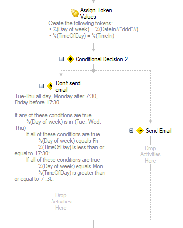

I think something like extracting the time and day of the week from the date, then the range when emails shouldn't be sent, breaks down as :
  • It's either Tuesday, Wednesday or Thursday
  • OR (it's Friday AND it's before 5:30PM)
  • OR (it's Monday AND it's after 7:30AM)
(WARNING: very lightly tested!)

replied on October 7, 2020

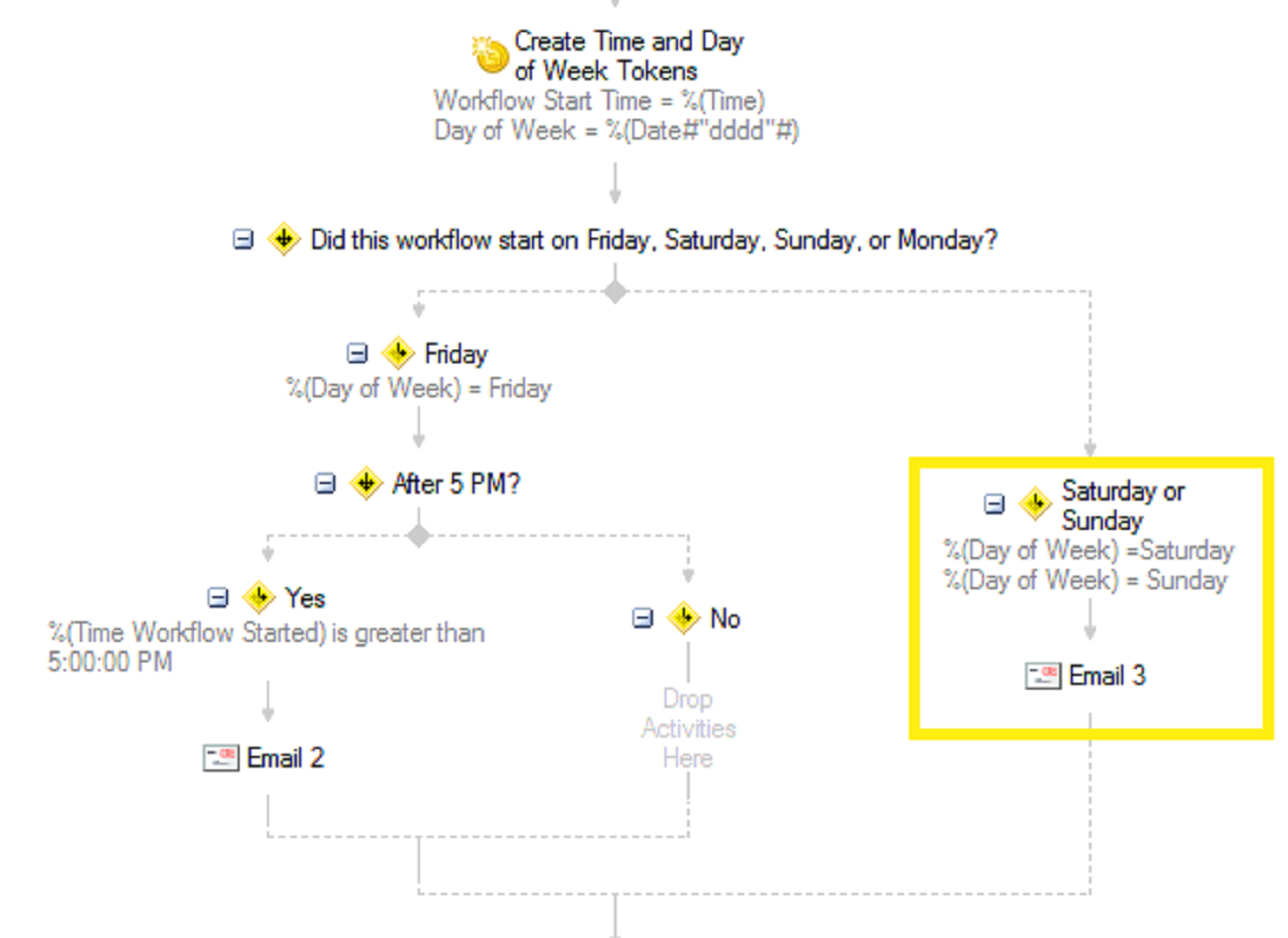

Makes sense. I ended up creating this prior to seeing your reply.
After talking with the customer, anything created on Monday before 7:30 AM isn't anything special and the one email to dispatch should suffice. How does workflow evaluate a time token? Is "%(Time) > 5:00:00 PM" something that even makes sense to workflow?

replied on October 8, 2020
If you make sure your tokens are tagged as time, not string, they will evaluate as time.
Perfect. That'll be what makes this work. Thanks for the help!
