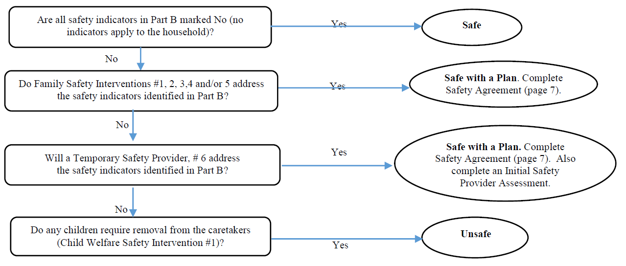

I have a form that I need to insert a picture into the form. The picture is actually a decision tree used by staff to decide what needs to happen with a case. See below:

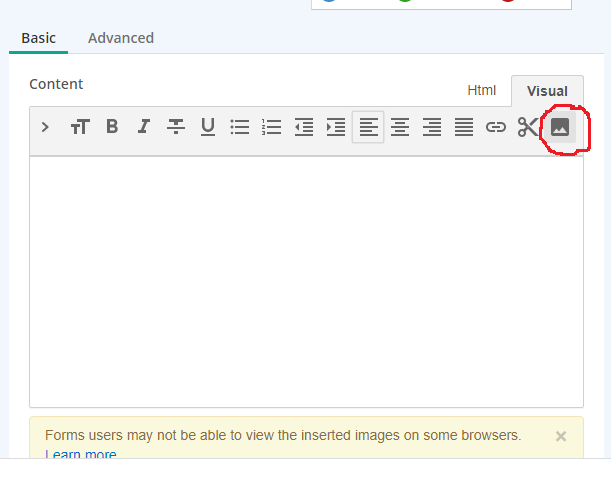

  1. In the visual tab of the Custom HTML area, click the image button.
  2. Select the image to upload.
The image will be uploaded but may be displayed quite large. To automatically adjust the image to fit your form do the following:
  1. Click Advanced in the Custom HTML area, and in CSS class enter customImage
  2. Go to CSS and Javascript and add the following to CSS:
    .customImage img{width:100%}
Now if you save and preview the form the image will be automatically adjusted to fit the form's width.

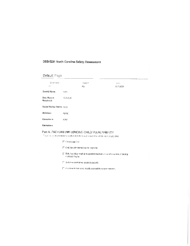

OK so now when I start the process and complete it, I am sending it to my email to print by it comes out like below taking with 1.5 inch side margins and 2.5 in margins top and bottom???
replied on October 7, 2020
In Forms settings in the toolbar of the form designer, you can control the form width. See if you can make that wider to fill the page.
(Also, if you want to follow up about this new issue further, please file a separate post with an appropriate title so other users can easily find it)
