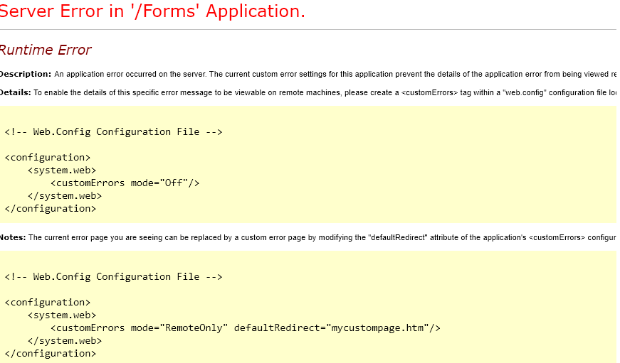

We updated our server from 10.4.0 to 10.4.5 today, everything seem fine, but then on 2 of our processes we are receiving Runtime Error on when submitting a form. We did not have this issue on 10.4.0, can anyone please tell me what could cause this? From what I see it is pointing to illegal character, but why did these errors not happen on 10.4.0?

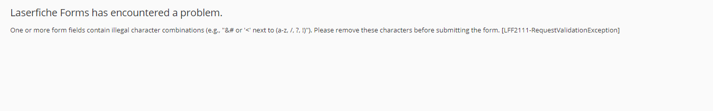

Is the multiline field read-only and the value is set via default value or lookup? With such setup, you will get runtime error after submit in 10.4.5 without modify the web.config. And in 10.4.0, you should get error as following since there will be error from IIS.

My first suggestion would be to go on the actual Forms server machine and reproducing the error there. The error you have copied and pasted is a sanitized error being viewed from a remote screen. If you go to the main Forms server and get this error, it will actually tell you more about what the problem is.
If you go to the Forms server, reproduce the error and still don't understand the error log, please either post that error here or open up a support case with that actual error so we can investigate more closely.

I saw this post https://answers.laserfiche.com/questions/116360/Does-Laserfiche-detect-and-block-potential-SQL-Injection#124642 and I changed the web config file as mentioned in this post which seem to sort out the issue. We have multiple value fields with HTML in. It is just weird that it worked on our 10.4 version and then on 10.4.5 it gave that error. The error log in event viewer was telling me the exact issue, when doing it from the server then I got the Same runtime error, but mentioning illegal characters. I assume I will have to do this for all our Forms servers when updating going forward.

This bug has been fixed in Forms 11, you will get same error as 10.4.0 instead of the runtime error.
