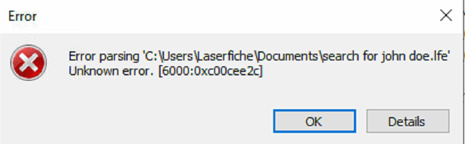

Hello,
I have a user who would like to receive an email every day containing an attachment that will open Laserfiche and show all relevant documents. In short, I want to return invoices that pertain to certain GL codes, as well as not having a certain tag assigned (the tag is applied when these documents get reviewed, and we exclude them from future search results this way).
Code snippet of the .lfe below:

My plan was to get this .lfe file created, throw it in Laserfiche somewhere, and attach it to this daily email. However, I must have something wrong here as I get the following error every time I try to open this file
Does anything stand out in the XML that might be causing this? The search syntax appears to be correct - I can paste it into an advanced search and it returns what I'm looking for.

replied on September 29, 2020
Never mind - I had to escape the ampersand and quotes within my search syntax. Working as expected now.
