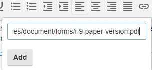

I am trying to add links in my form and they are being set to javascript:void(0) instead of the link I enter.
Hidden within the code, you can see hidden instructions which say to hold CTRL + Click the link. If I do this the link works, but no one would ever know to do this because they are not looking at the code.

This is what it generates for HTML.
<a href="javascript:void(0);" title="http://test
CTRL +Click to follow link" style="cursor:pointer" onclick="if (event.ctrlKey) window.open('http://test', '_blank');">test</a>
It is less of a browser specific thing, and more of a why is all this javascript here and why the dependency on the control key. Anytime someone adds a link to their form it will not work unless the user has the control key pressed.

After a little digging, it appears this change was actually meant only for RTF fields. When a form filler is editing the RTF field, their links were too easy to click in the editable input which would navigate away from the in-progress form. I think the change accidentally propagated to custom HTML fields that should just allow single click to access the URL.
We'll look into this further and see if we can straighten it out. Thanks for bringing this to our attention.

This issue was about clicking a link from a custom HTML field on the form in the browser, and it was fixed. Now if the link is in edit mode (like in the custom HTML editor), it requires a control + click. If the link is in read-only mode (like on the form itself), it works with just a single click.
Matt for your issue, if you go into the HTML side of the body and update the <a href> tag with the correct link, does the email work?
replied on August 17, 2021
Thanks for clarifying Jared. Going into the HTML side of the body and manually crafting the links works. However, it looks to me like using the Hyperlink button provided in the Visual side causes issues. When I tried using that button to create a link in the body, the 'Ctrl+Click' HTML code appears to cause a lot of havoc. I tried to simply delete these pieces and replace with simple <a href> tags but when I'd go over to the Visual side it changed what I typed and added a lot of crazy stuff. Almost like it was tying to do things differently.
In order to get this working I manually deleted everything in the body and wrote the <a href> tags myself. After trial and error, I found that if you try using the Hyperlink button and then editing after, it doesn't work correctly. It appears to me like using the button to create links is broken, as the behavior it results in renders the links unusable in the resultant email.
