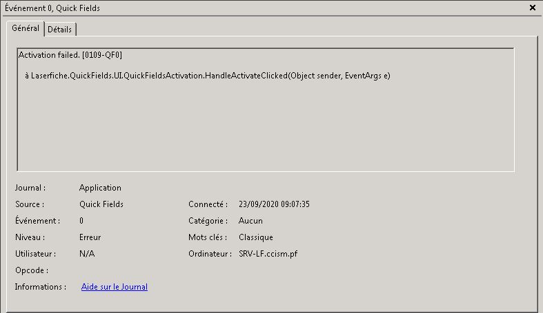

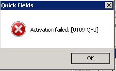

Now 10.3 is installed but I can't active it. I get the error "Activation failed. [0109-QF0]".
In the event logs I don't have more information.

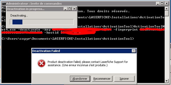

Using ActivationtoolNet4, I tried to deactivate the licence but I get the error "Product deactivation failed".

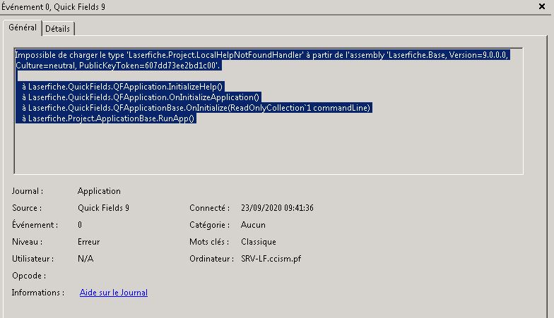

I tried to uninstall QF 10.3 and back to QF 9.0 but the application QF 9.0 doesn't open. I don't have error. I'm clicking on the icon but nothing happening.

If the client's LSAP is expired, that's what caused the activation to fail. Product activation can only be completed with a valid, active LSAP.
Deactivation should be able to be completed with an expired LSAP. However, I believe what happened is when you tried to activate 10.3, it deactivated 9.0, then failed to activate 10.3 due to expired LSAP.
The subsequent deactivation attempt failed because it was already deactivated.
You should be able to check the client's account on the LF Support site under "Activation Keys" to see the number of activations remaining for that product (if it shows "1" then the deactivation completed and you won't be able to activate again until the LSAP is brought current; if it shows no value under that column, then the deactivation didn't complete and you may need to reach out to LF Support to get the correct Host ID and Hardware Fingerprint to deactivate)
In either scenario, the customer's LSAP needs to be brought back to an active status before you can do anything.
