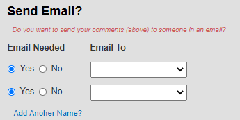

replied on September 18, 2020
Success today!  It didn't work and I tried to figure out why for a full day and then realized that, because the radio button is within a table, I did not have the variable name correct.  I had the table name variable name in there, not the column name.  Once I fixed that, it worked.  Then tested where a person might ADD another name in the table and both people did receive the email in the test!
It's a table and a radio button "Yes".
/dataset/Email_/Email_Needed="Yes"
