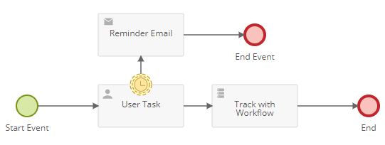

For a situation like this I would use Workflow as my starting point, assuming you have an on-prem system.
The workflow can be scheduled to run on specific days/times or can be run manually, it can do data lookups, and it can kick off Forms tasks and pass in variables or build the URL. Starting the Forms process would be a little safer if you're sending anything more than numbers to pre-fill the form. This is done with the Invoke Business Process activity.
In that case, you'll want the form to start with a simple Start event, then the first task will be a user task with the form assigned. This task can have an email reminder on it, or you can use WF for reminders.
Workflow can use database calls to both log who these were sent to and track when they are completed and send email reminders to everybody who is still waiting.

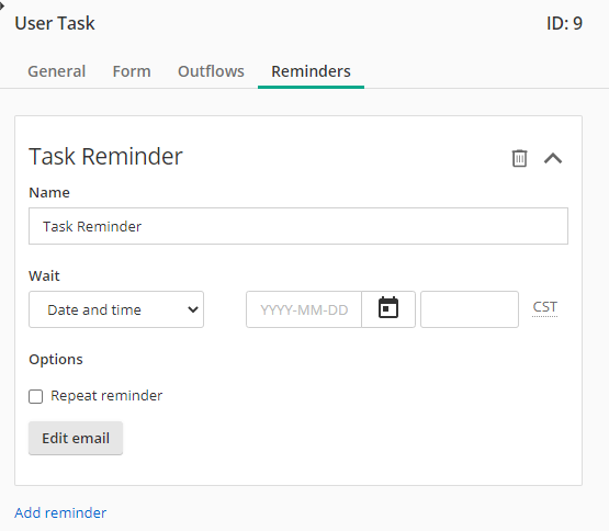

The recently released Forms 10.4.5(https://support.laserfiche.com/download/4149/laserfiche-forms-10-4-5) added the out of box reminders feature for user task, you can add reminders for each user task and it can control when to send the reminder email and the content of the email.
replied on September 14, 2020
That won't help for proactive notifications (like, "it's time to go complete your time sheet"), but is a fantastic enhancement for regular task reminders.
If the task has been Reassigned, does the reminder go to the person who currently owns the task, or to the person it was assigned to originally?
It will go to the person who currently owns the task.

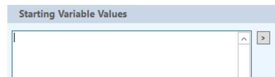

I am assuming that you are using Forms to submit time sheets. Use a scheduled Workflow that kicks of x number of weeks. Include the activity for "Invoke Business Process" where you pass employee parameters to the the Form via the 'Starting Variable Values' section:
