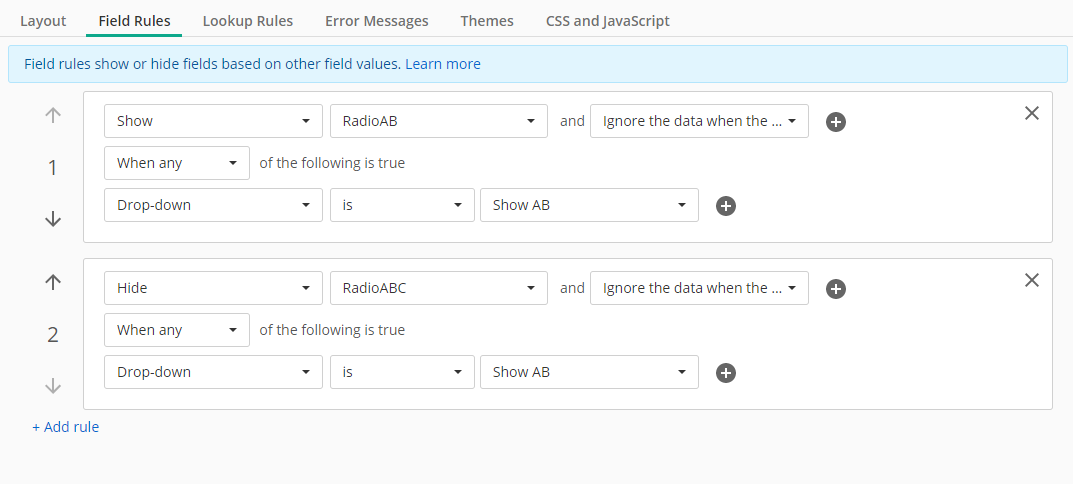

It might be easier to do this with Field Rules rather than JavaScript.

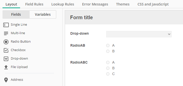

Create two Radio Button areas: one with A, B, C and another with A, B.
In Field Rules, set two rules: one to show the A, B and another to hide the A, B, C:
You can add additional Field Rules to show/hide either Radio Button area based on the Drop-down option selected.
