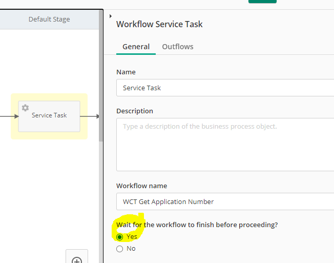

This is a bare bones example, it can be fleshed it out with your specifics.  It assumes a 'starting' form with basic fields and an 'approval' form that includes an Application Number field.  The stored procedure will generate the new application number and workflow will make that value available to the 'approval' form via workflow.   The first step after the Starting Form is submitted is to run a Service Task that calls the workflow.
Make sure the Service Task is configured to wait for the workflow to finish before proceeding.

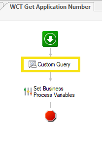

The workflow that we will call is very simple.  It calls the stored procedure and then stores the resulting application number to the approval form field.

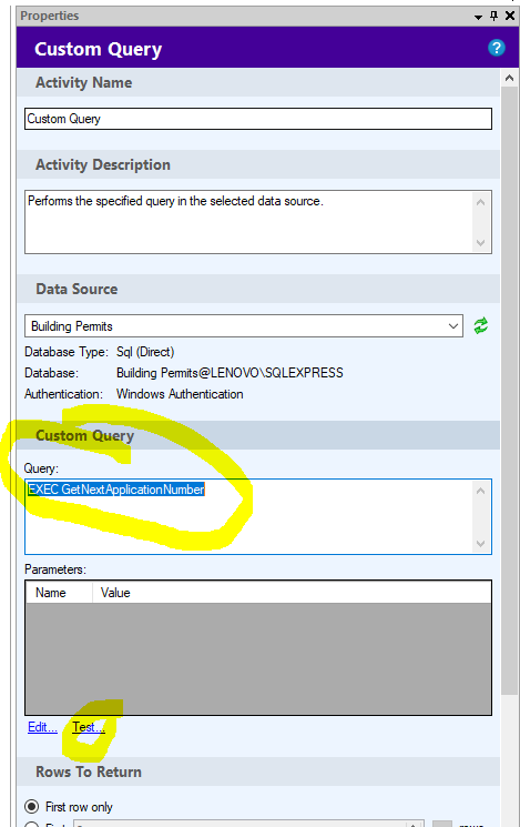

To call the SQL stored procedure use a Custom Query workflow activity.  (Note: In this example the stored procedure does not require any parameters to be passed to it.  Your stored procedure might require parameters.  Also, you must 'test' the Custom Query to let workflow know what fields and values are actually being returned from the stored procedure).

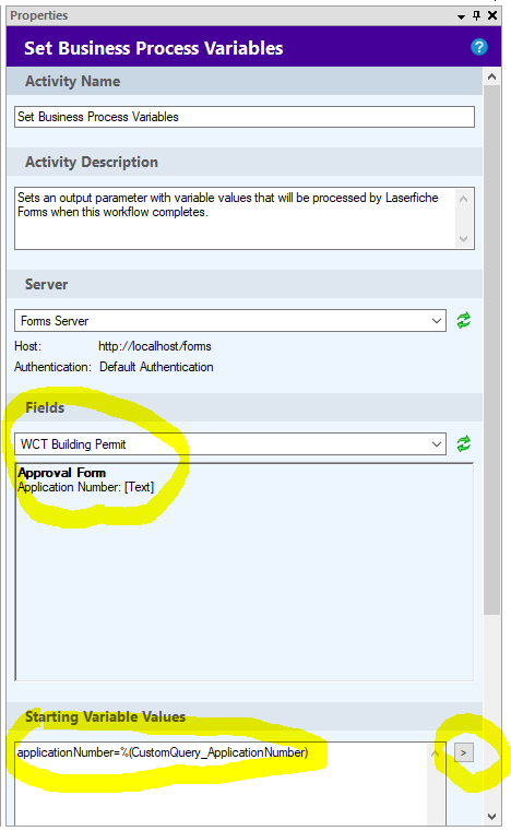

In the Set Business Process Variables activity we set the Application Number field from the Approval form to the application number value returned by the stored procedure.   Use the token button to select the Form variable to set and the same token button to set that Form variable equal to the results of the custom query.

Your stored procedure is not using any parameters and it is returning a numeric value called GWNUMBER.
I would just try EXEC GW_1_counter in the custom query and test it.
However, each time you call your stored procedure to test it your GWNUMBER is going to increment so you will have to go into SQL and clean up the underlying table.
