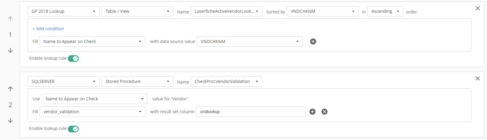

  1. Create a stored procedure to verify validation that the value exists in the database. This procedure will trigger as soon as the single line is filled in.
  2. Create a hidden "output" field on the form that will show True or False based on whether the value exists in the lookup table.

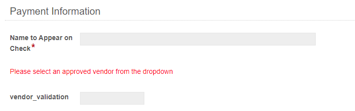

  3. Add a custom HTML field + JavaScript to show an error + hide the submit button when the validtion output = false.
Here's some screenshots of each component.
vendchknum is the field we are pulling on the single line lookup. I assigned that same field the @Vendor variable in the stored procedure. Then I'm filling the output of the procedure with the vndlookup column.
Here's the form itself with the 3 fields. I used field rules to hide vendor_validation always but I save the data. Then I used field rules to show the custom HTML so the error is only visible when vendor_validtion = True

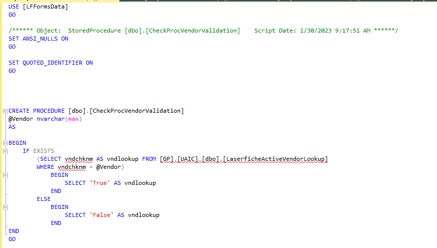

Stored Procedure
USE [LFFormsData]
GO
/****** Object:  StoredProcedure [dbo].[CheckProcVendorValidation]    Script Date: 1/30/2023 9:17:51 AM ******/
SET ANSI_NULLS ON
GO
SET QUOTED_IDENTIFIER ON
GO
CREATE PROCEDURE [dbo].[CheckProcVendorValidation]
@Vendor nvarchar(max)
AS
BEGIN
	IF EXISTS
		(SELECT vndchknm AS vndlookup FROM [GP].[UAIC].[dbo].[LaserficheActiveVendorLookup]
		WHERE vndchknm = @Vendor)
			BEGIN
				SELECT 'True' AS vndlookup
			END
		ELSE
			BEGIN
				SELECT 'False' AS vndlookup
			END
END
GO

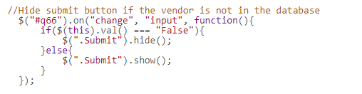

JavaScript to hide Submit (replace q66 with the ID of your output field)
  //Hide submit button if the vendor is not in the database
    $("#q66").on("change", "input", function(){
        if($(this).val() === "False"){
            $(".Submit").hide();
        }else{
            $(".Submit").show();
replied on February 23, 2023
	IF EXISTS
		WHERE vndchknm COLLATE Latin1_General_CS_AS = @Vendor COLLATE Latin1_General_CS_AS )
			BEGIN
			END
		ELSE
			BEGIN
			END
			--COLLATE Latin1_General_CS_AS (this piece will check for case sensitivity in the string
One last note on the SQL procedure. If you need to add case-sensitivity for the string lookup, add the COLLATE commands
