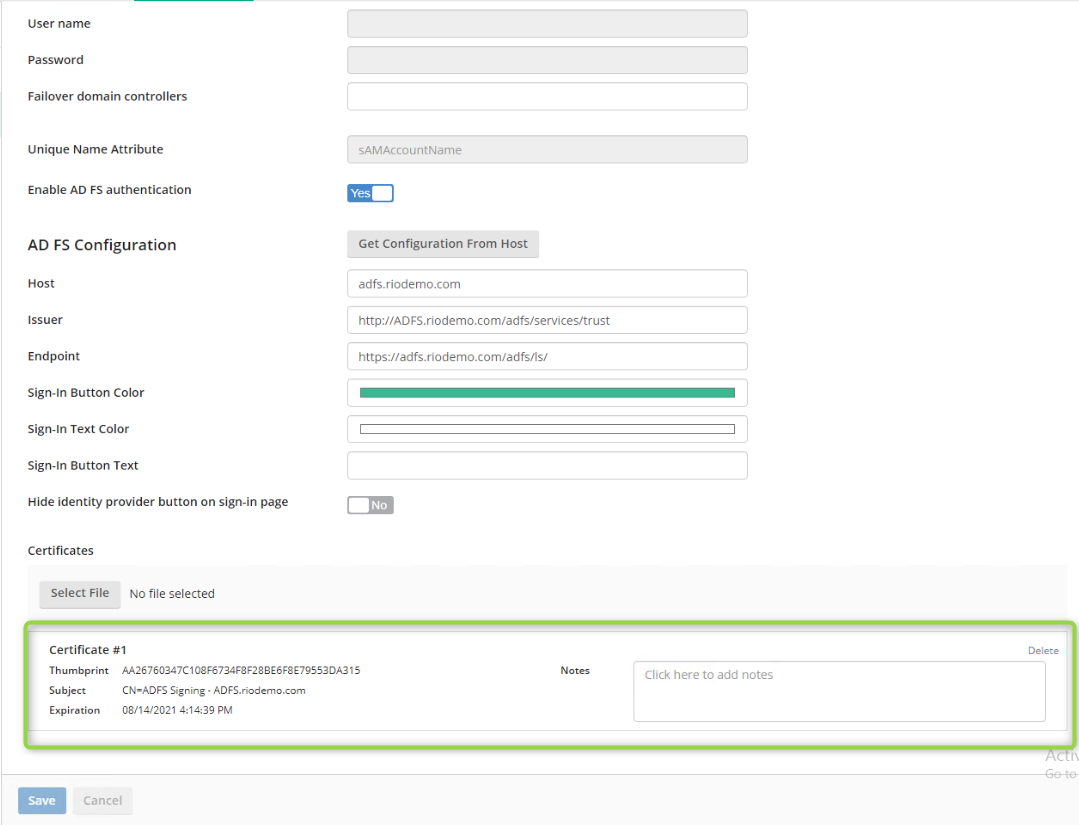

Should the certificate be deleted in this case as well?
replied on August 25, 2020
That certificate is for signing and needs to be there. You should be able to just turn off assertion encryption in AD FS.
