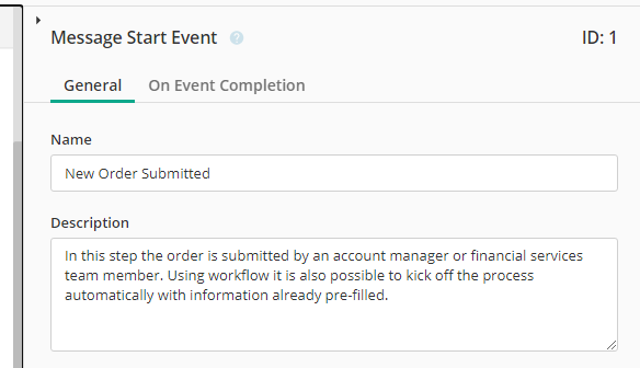

For those not familiar, if you build out your processes in the Forms Process Modeller and actually include a "description" with each node..
The Documentation View automatically references that description as part of the process documentation generator.

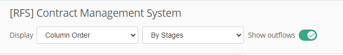

For example.. using the following settings:
The order of events should go by column (from top to bottom, then move to the next column), and then limit each block of columns by stage.

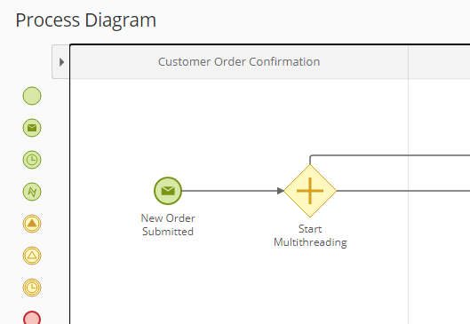

So lets look at our process map..

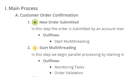

As you can see we have a starting message event, then a parallel gateway which splits into two and then that is the end of the "Customer Order Confirmation" stage.
Technically, our documentation should show two nodes within the first stage.

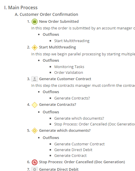

But instead, we see:

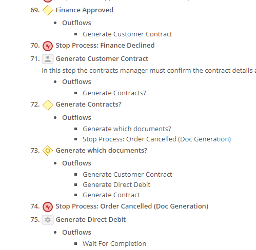

Which is completely random, since, without grouping by stage, Contract Generation is about 60-70 steps away and actually requires approval..

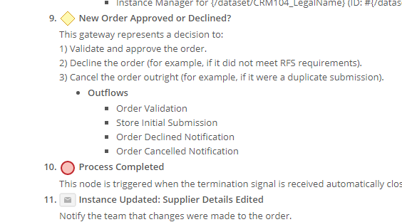

See, without stages.. instead we get things like the "Process Completed" node among other random nodes showing up in the first stage. The process completed node is the final step of the final stage.

    The first issue about group into wrong stage is a known issue when the stage ID>10. For the second issue about the last step is ordered in the middle, we can't reproduce it, can you please open a support case and provide your download process?

For the issue that the order is incorrect when the stage ID>10, it will be fixed with the coming 10.4.5 which will be released at the next Patch Tuesday(9/8/2020).
