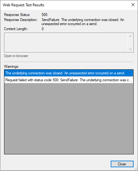

I'm trying to get connected from LFWorkflow to a an API for a third-party vendor we utilize.
I'm able to get LFWorkflow to connect to their authentication API and retrieve the JWT token, but then when I try to complete the next stage of their process to their regular API (a GET request using that JWT token) it just fails every time, no matter what I try to do.

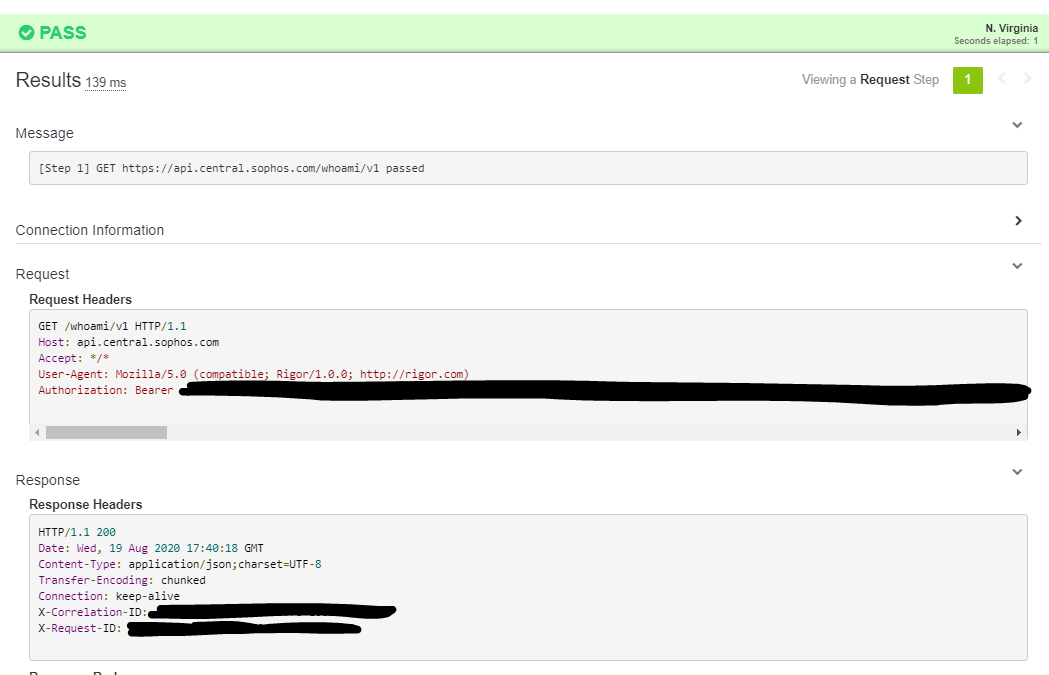

When I test the request using apitester.com it works just fine.
But when I try to run the request through the HTTP Web Request tool in LFWorkflow, it fails every time.
Has any one seen this issue before, and have any suggestions on other things that I can try?

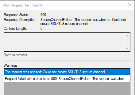

I've been battling a similar response error that appears in Laserfiche Web Client after attempting to launch a Business Process manually.
Entry 'AP Batch Auditing [AFA-EBS]' resulted in error: The underlying connection was closed: Could not establish trust relationship for the SSL/TLS secure channel.

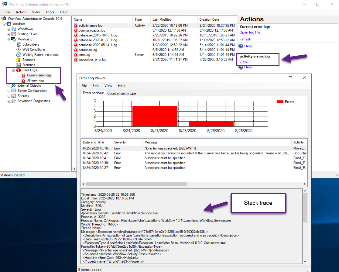

Workflow Admin Console -> Monitoring -> Error Logs -> [Select] -> [View]
I suspect it would be in "activity errors.log" since it's surfacing through a Web Request activity, though "communication.log" is also a possibility.
replied on September 8, 2020
Weird.  It doesn't appear to be putting this error in those logs.  I can see plenty of other errors, but nothing newer than early this morning - regarless of the fact that I've run a dozen or more tests of this item since then.
