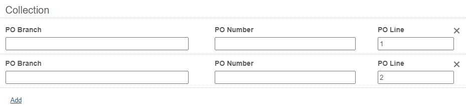

replied on August 18, 2020
Oops. The first CSS element, for DetailLines, wasn't closed properly. Accidentally used a parenthesis instead of a curly bracket. Fixing that led to proper spacing:

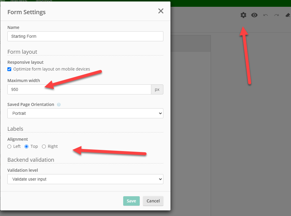

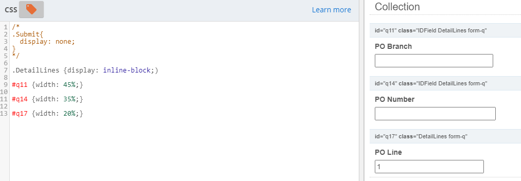

Hi Grant-
A few thoughts.
  1. Change the alignment of the label to "above" the field, rather than to the left.
  2. Make the form a bit wider. At the default 800 I had issues with the 3rd field dropping to the next line; making it wider corrected that (maybe a hard-coded padding setting?)
  3. I removed the .cf... from the CSS and just use the #q number. Note that I recommend setting classes for things like "WideField" and "MediumField" so that you don't have to duplicate your work.
  4. Set the field width, from the form layout, to X-Large. That will make the text box take up the full width of the field. Otherwise you'll have to add cf-field or input settings to your CSS.
  5. Getting a specific layout can take a bit of time and effort

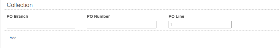

Hey Pieter, thanks for the quick response.  I didn't know about setting the form width from the settings so that's helpful.  I am a little confused with the rest of your solution (or at least judging from your screenshots) because your fields look to be all the same width.  PO line might be a little smaller but what I'm looking for is field 1 (PO Branch in your sample) to take up almost 50% of the row/line.  The second field would then take up about a third of the row and the last field would be small and just take up roughly a fourth of the line.
Here's a screenshot of what I'm trying to accomplish (this was done with Forms Tables where you can easily specify how big you want each field to be using % numbers.
Ok great that's exactly what I'm looking for.
Thank you Pieter!
