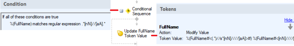

replied on August 13, 2020 • Show version history
Another way to handle this is to have the FullName token populate with the "N/A" value as the middle name and then use a conditional sequence where if FullName matches Regular Expression .*[nN]//[aA].* then set the FullName Token = %(FullName#<(.*)//s*[nN]////[aA]>#) %(FullName#<[nN]////[aA]//s*(.*)>#)
