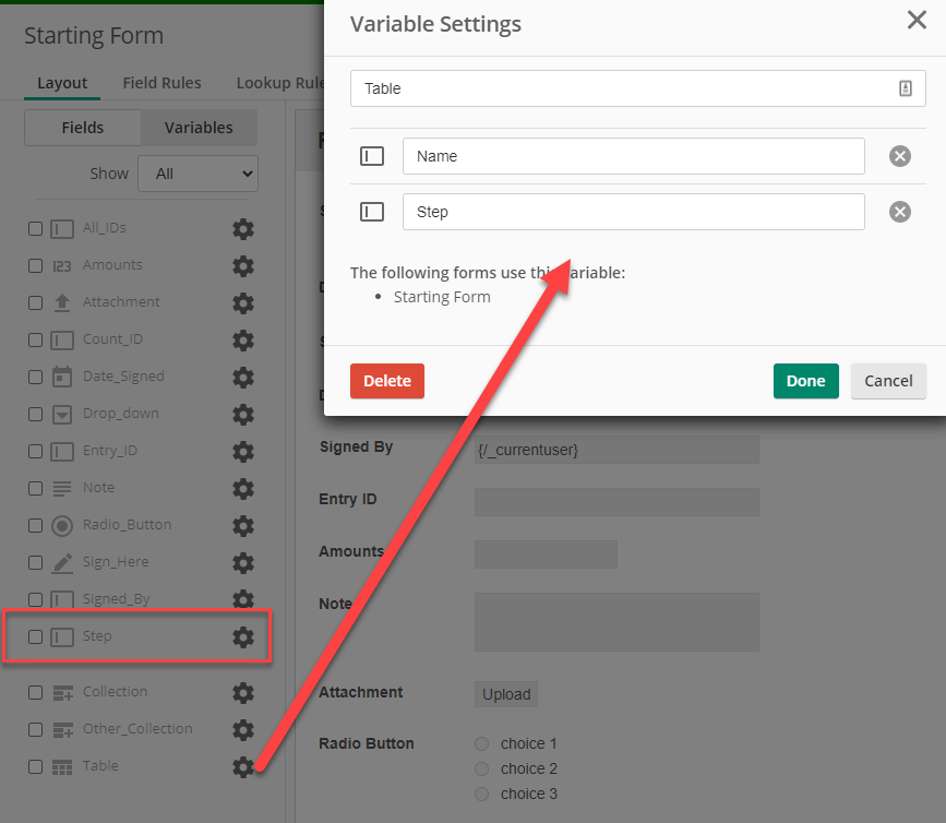

I have run into this issue in the past with a large form with multiple tables. The issue was the my main field, something like ProjectNumber, was also the name of a variable in the tables. I forget what circumstances cause the primary field to get lost by WF (one filled the other not maybe), but the fix was to go into my tables and rename the variable slightly so that they did not match the version at the top of my form.
replied on August 10, 2020
I may not be following you here.  Are you talking about a variable in your form table that you renamed?
Yes. Here's  a screenshot with a simple example. There is a "Step" variable on the form directly and one within the table. One of them should be renamed.
Note that if you rename one or more fields used within a workflow, you'll need to update the workflow to use the new variable name.
For what it's worth, I ran into this with Forms 10.2 and 10.3 with Workflow 10.2. I do not know if it's still an issue with 10.4 of each of those module.
