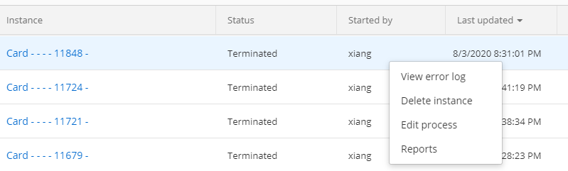

      From Monitor page, you can view the error log for the terminated instance.
 We've also gotten feature request of including the error message in the email notification as attachment before.
