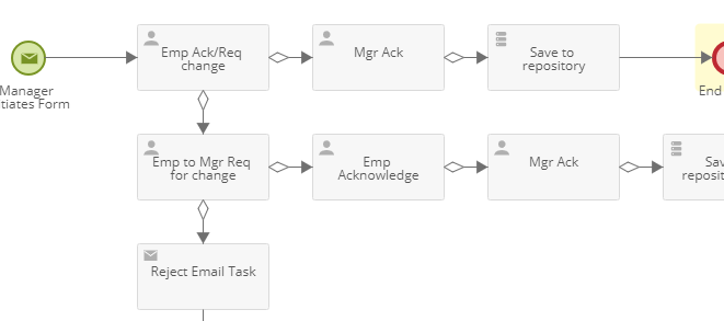

There are multiple pathways based on if the employee selects Acknowledge or Request for change options.If it's acknowledge by employee below steps describe the scenario.
1.Manager initiates
2.Employee Acknowledges (Acknowledgement fields not read only) (User task)
3.Manager gets the form back for verification (Acknowledgement fields read only) (User task)
If it's request for change by employee below are the steps.
1. Manager initiates
2.Employee request for change(Acknowledgement fields not read only) (User task)
3.Manager gets the form back  and approves the change(Acknowledgement fields read only) (User task)
4.Employee receives the manager approval and places his signature in the form (Acknowledgement fields not read only) (user task)
5.Manager receives the employee acknowledgement and approves(Acknowledgement fields read only) (User Task)
Basically when the employee gets the form (Signature acknowledgement field need not be read only.)
When the manager receives the form the signature acknowledgement needs to be read only.

This is what i did:
Set the acknowledgement fields to read only in js.
When the stepID !=1  show the fields and make read only as false. (emp ack)
When it goes to manager ack stage there is an option on the usertask to make the form to be readonly the task is assigned to and i check that option.
This helped me to toggel between the options with a minimal code in js.
