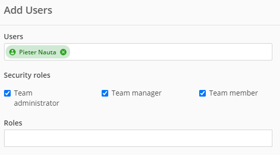

replied on July 28, 2020
Are you talking about on-prem? I have no experience with Cloud, so can't speak to that.
I've set users up with all 3 rolls for quite some time. This is what it looks like in 10.4.4
replied on July 29, 2020
Ah I figured out how to do it. It is just not letting me add them as a team member using the Add button I normally use, their name doesn't show up in the search once they are set as an Admin.
I had to click on their name and check the box Team Member. Thanks!
